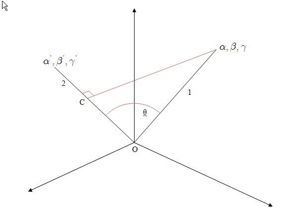

Prove:
\cos\alpha\cdot\cos\alpha'+\cos\beta\cdot\cos\beta'+\cos\gamma\cdot\cos \gamma'=\cos\theta
See drawing Snap1
None
See drawing Snap2. i make the length of the lines 1 and 2 to equal one, for simplicity.
The projection of line 1 on one of the axes is cos(α).
##\cos\alpha\cdot\cos\beta## is the projection of line OA=cos(α) on line 2, which causes line AB to be perpendicular to line 2.
If i will make the same procedure for all 3 axes and add the 3 projections on line 2 i have to get, see Snap1, line OC which is ##1\cdot\cos\theta##, but i don't know how to do it.
The book from which i took this problem says i have to solve it from geometrical considerations.
Where can i find the proof to this problem?

You have two straight lines given with their direction cosines, and θ is the angle between the lines?
The direction cosines are the Cartesian components of the unit tangent vector of the line. ##\vec e_1=<\cos(\alpha);\cos(\beta);\cos(\gamma)> ## and ##\vec e_2=<\cos(\alpha');\cos(\beta');\cos(\gamma')> ##. The dot product of the unit vectors ##\vec e_1## and ##\vec e_2## is ##\vec e_1\cdot\vec e_2 =\cos(\alpha)\cos(\alpha')+\cos(\beta)\cos(\beta')+\cos(\gamma) \cos( \gamma ')##. How is the dot product related to the angle θ between the unit vectors?
ehild
Thanks, Ehild, the dot product is just that, the cos between the lines.
