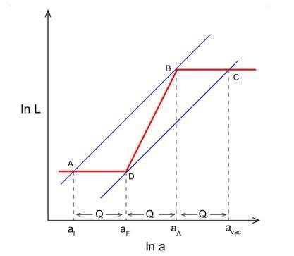

The Hubble parameter during the inflationary epoch [1st de Sitter phase] is the Planck length [Lp]. The inflationary epoch is assumed to end when the de Sitter temperature is reached, defined as Tp = 1/(2piLp). This occurs at point D on p3 graph, the beginning of the radiation epoch. The radiation epoch ends when the number of comoving wave vectors that reenter the Hubble radius is the same as the number that exited during the inflationary epoch. This occurs at point B on p3 graph, which also marks the beginning of the second de Sitter phase. Q is the expansion factor, which is expected to be the same during all three epochs. It appears to me you can use the point when accelerated expansion began as the start of the second de Sitter phase.

From his page 7, second bullet:
Time translation invariance of the geometry suggests that de Sitter space-
time qualifies as some kind of “equilibrium” configuration. Given the two
length scales, one can envisage two de Sitter phases for the universe, one
governed by H = Lp−1 and the other governed by H = (Λ/3)1/2. Of these,
I would expect the Planck scale inflationary phase to be an unstable equi-
librium causing the universe to make a transition towards the second de
Sitter phase governed by the cosmological constant. The transient stage
is populated by matter emerging along with classical geometry around the
point D in Fig. 1.
I don't quite catch the meaning of the last sentence. Does he mean that all the radiation and matter (energy) that we observe emerged around point D, or did it gradually emerge during the middle phase (D to B), i.e. migrated from the left side of the parallelogram to the right side? We are presumable situated very near point B, busy entering phase B to C.

Me neither. The emergent phase is not well characterized. It appears he asserts a quantum gravity solution is required on that count.
