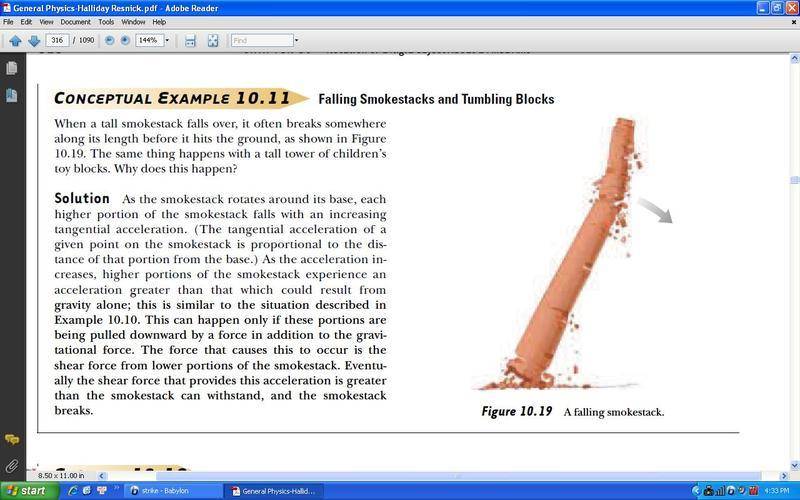

Could someone help me explain this situation
  • Thread starter Thread starter tukms
    Explain
tukms
I have read a section but I don’t know their explanation , so please explain for me
Thank you
Hi,
Top/tip of the tower accelerates faster than bottom. Please read the lines inside ( ).
difference in shear force between bottom and top of the tower makes the tower to break.
hi tukms! :smile:
each brick is trying to pull the next brick, but there's a limit to how hard it can pull without the mortar (joining the bricks) breaking
that limit is the maximum shear force ("shear" means sideways to the join)
force = mass time acceleration, so if the acceleration is too large, then the force exceeeds the maximum shear force, and the mortar breaks :wink:
