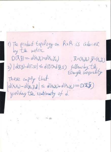

Let ##X## be a metric space with metric ##d##. Show that ##d: X \times X \mapsto \mathbb{R}## is continuous.
Please try to poke holes in my proof, and if it is correct, please let me know if there's any more efficient way to do it. Any help would be greatly appreciated! Here is my proof:
First, we show that for any fixed ##\textbf{x}##, the set ##A(\textbf{x},\epsilon)## defined as ##\{\textbf{y}|d(\textbf{x},\textbf{y}) > \epsilon\}## is open in ##X## under its metric topology. Suppose ##\textbf{y} \in A(\textbf{x},\epsilon)##. Then, consider ##B_d(\textbf{y},d(\textbf{x},\textbf{y})-\epsilon)##. We show that this open ball lies entirely in ##A(\textbf{x},\epsilon)##. Suppose ##\textbf{z} \in B_d(\textbf{y},d(\textbf{x},\textbf{y})-\epsilon)##. Then,

Your proof is correct.Another approach for RxR concerns the metric inducing the topology on RXR.
See attached.
for general metric space use appropriate metric.see answer #3.
metric for the producy topology
