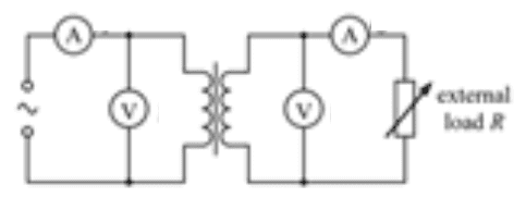

Diagram below shows a transformer having primary coil with resistance of 470 Ω and secondary coil with resistance 2950 Ω. The r.m.s potential difference across primary coil was maintained at 6 V. The efficiency of the transformer varies as R varies and when the transformer operates at maximum efficiency of 0.42, R is 13.5 kΩ. If the ratio of input and output voltage is 1 : 2, find:
a) the current in R
b) power loss in primary coil
##P=I^2 . R##
P = V.I
##P=\frac{V^2}{R}##
a) Output voltage = 2 x 6 = 12 V
Current in R = 12 V / 13.5 kΩ = 8.9 x 10-4 A
That is the correct answer based on the solution but I don't understand why when calculating the current in R, the resistance of secondary coil is not considered. I thought it should be like this:
Current in R = 12 / (13.5 x 103 + 2950) = 7.3 x 10-4 A
Thanks

Are those two resistances in series as far as the voltmeter is concerned?
What is the potential across the external load?
I am also tending towards the view that we should take the resistance of the secondary into account, however i am not so sure. The reason is (I think) from an energy/power point of view that $$V_sI_s=I_s^2R_s+I_s^2R\Rightarrow V_s=I_sR_s+I_sR$$
So what do you think the right hand voltmeter reads, and how would you define "output voltage"?
The right hand voltmeter says ##\frac{12}{R_S+R}R## and the output voltage is 12

Delta2 said:
Tbh, I feel something just isn't quite right in what I am saying but not sure what it is. I think I am not sure if the voltage meter reads 12V or what I say in post #5.
If it does not refer to what the right hand voltmeter shows then it is not clear to me how output voltage is to be defined.
haruspex said:
From the perspective of the voltmeter, yes.
So it means that the p.d. across coil is also 12 V
If I calculate the current through the secondary coil, it would be = 12 / 2950 = 4 x 10-3 A
Why the current in secondary coil is not the same as current in R?
Thanks

Delta2 said:
What I have in mind is that the secondary of the transformer is like an EMF source with ##E=12V## and internal resistance ##2950\Omega##
So it would be the open circuit voltage. Seems fair.
But that just makes the text ambiguous, and the given solution takes the other view.

Hi, I’m chipping-in if I may...
a) The output voltage (between the secondary's terminals) is 12V - because we are told it is twice 6V.
The current through R is therefore ##I = \frac V R = \frac {12}{13.5\times10^3} = 8.9 \times10^{-4} A##
__________
Side-note
The secondary coil and the load have the same current, so the voltage-drop (‘lost volts’)across the secondary coil’s internal resistance (r) is ##Ir = 8.9 \times 10^{-4} \times 2950 = 2.6V.##
That means the secondary’s emf ##= 12+2.6 = 14.6##V.
__________
b) There is no need to find the primary current (or even use the primary’s resistance).
The power delivered to R is ##\frac {V^2}{R} = \frac {12^2}{13.5\times10^3} = 0.0107W##
The tranformer’s efficiency is 0.42. That means the input power to the transformer is ##\frac {0.0107}{0.42} = 0.0254##W
From conservation of energy, the power loss in the primary coil is then:
(input power) – (power dissipated in R) – (power dissipated in secondary coil)

The official answer to part a) (8.9x10⁻⁴A) is calculated by taking the secondary’s terminal voltage as 12V. (This means the emf = 14.6V.)
But the official answer to part b) (8.3x10⁻³W) has been calculated assuming the emf is 12V (which would make the secondary’s terminal voltage less than 12V).
That's what's gone wrong.
So I would say the official answer to part b) is wrong. The incorrect answer (8.3x10⁻³W) can be calculated, by (incorrectly) taking the emf as 12V, as follows:
Current in secondary ## I = \frac {V}{R+r} = \frac {12}{2950+13500} = 0.0007295A##
Power loss in secondary coil ##= I^2r = 0.0007295^2 \times 2950 = 0.00157W##
Power delivered to R ##= I^2R = 0.0007295^2 \times 13500 = 0.007184W##
Input power to primary ##= \frac {0.007184}{0.42} = 0.0171W##
Power loss in primary coil ##= 0.0171 – 0.00157 – 0.007184 = 0.0083W##
(And note, there is no need to use the primary’s resistance unless you are also required to find the primary current. Conservation of energy makes the calculation much simpler!)
Edit: Of course it could be the other way round: the official answer to part a) is wrong and the answer for part b) is correct.
