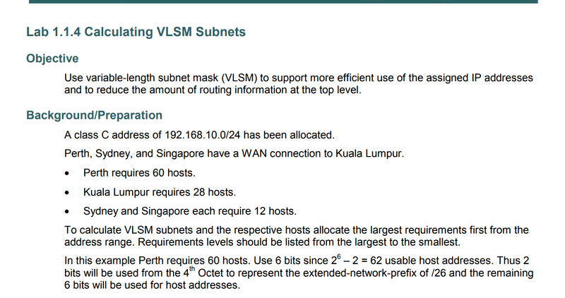

https://www.cisco.com/c/dam/en_us/training-events/netacad/demos/CCNA3v3Demo/PDF/lab_1_1_4.pdf
This is the pdf I am studying from. This is not exactly what I need for my exams but it’s pretty clearly written and concept giving thing.
192.168.10.0/24 is given IP address to subnet.
We need 4 subnets

Conceptually, there would be four subnets created, each able to serve 62 hosts. Because 3 of the locations can fit into one subnet (52 hosts required), only two of these subnets are used (192.168.10.0/26 and 192.168.10.64/26). The first is used for Perth and the second is divided into two sub-subnets (192.168.10.64/27 and 192.168.10.96/27). The first of those is used for KL and the second sub-subnet is divided into two sub-sub-subnets (192.168.10.96/28 and 192.168.10.112/28). The first sub-sub-subnet is allocated to Sydney and the second to Singapore.
I am not sure why they did it this way. It may be to accommodate more locations. But if any location needs another 3 host addresses you have to reconfigure the other locations.
To accommodate future expansions, it might be better to divide into two subnets ie. 192.168.10.0/25 and 192.168.10.128/25 and give the first to Perth (using only half eg. 192.168.10.0/26). Then divide the second subnet into two sub-subnets ie. 192.168.10.128/26 and 192.168.10.192/26 and give the first to KL (using only half eg. 192.168.10.128/27). Then divide the second into two sub-sub-subnets ie. 192.168.10.192/27 and 192.168.10.224/27 for each of Sydney and Singapore (using only half for each eg. 192.168.10.192/28 for Sydney and 192.168.224/28 for Singapore)
Regardless of how you allocated the subnets, you would use the mask 255.255.255.192 for the Perth subnetwork, the mask 255.255.255.224 for the Kuala Lumpur sub-subnetwork and the mask 255.255.255.240 for each of the Sydney and Singapore sub-sub-subnetworks.
The final part (3 not 4 WAN links) is not explained and expects you to know that each WAN router has to be on its own subnet. The KL router is the top level.
