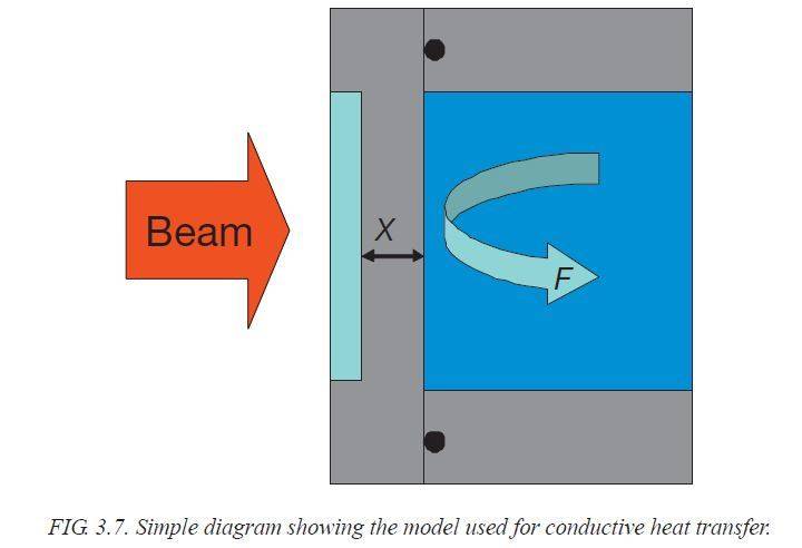

https://www.dropbox.com/s/pwkgce1d9rcj3ev/target.JPG
The beam is fully stopped in the target material (light blue) before reaching x.
I'm curious is this how the cyclotron that produce medical isotope measure beam current.
Please advise me that if there is any reference about it.

The diagram shows "a simple model for conductive heat transfer" and does not appear to have anything to do with protons.

Note: the "typical system" in your diagram does not include a faraday cup - or any provision for detectors.
It describes a commercial-type setup - which will already have it's own arrangement of detectors.

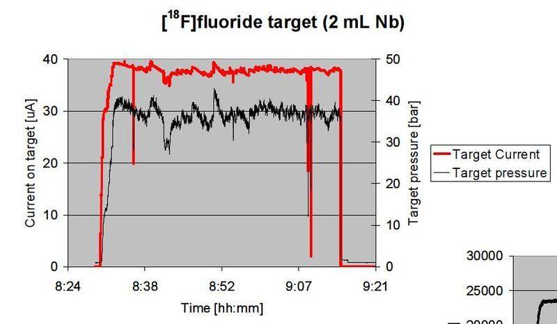

Commercial-type setup like this one connect a current meter with the right (green) side of the target body.
A colleague explains to me that once the proton enter the target, by the law of charge conservation, positive electricity carried by the proton must flows through the current meter if it's connected to the target body (metal, conductor).
I'm just wondering can the positive electricity carried by the proton flows through water if the proton stops in the water ?
Yeah - if the proton is completely absorbed in a solid target, and nothing else happens, then the target becomes slightly positively charged. This draws an electron from the wire that is attached to the target ...
Presumably you could get water to do this. You'd certainly end up with more protons than electrons in the water ... and that charge has to go somewhere.
This is nothing to do with a Faraday cup.
This is simple charge conservation - and the fact that even a tiny unbalanced charge leads to a huge electric potential. Your target will be close to neutral all the time, so if protons go in, there are some electrons flowing in as well. Current flow will use all available conductors, but if you provide the "best" connection to ground (lowest resistance) and attach a current measurement you should get a good estimate of the proton current.
