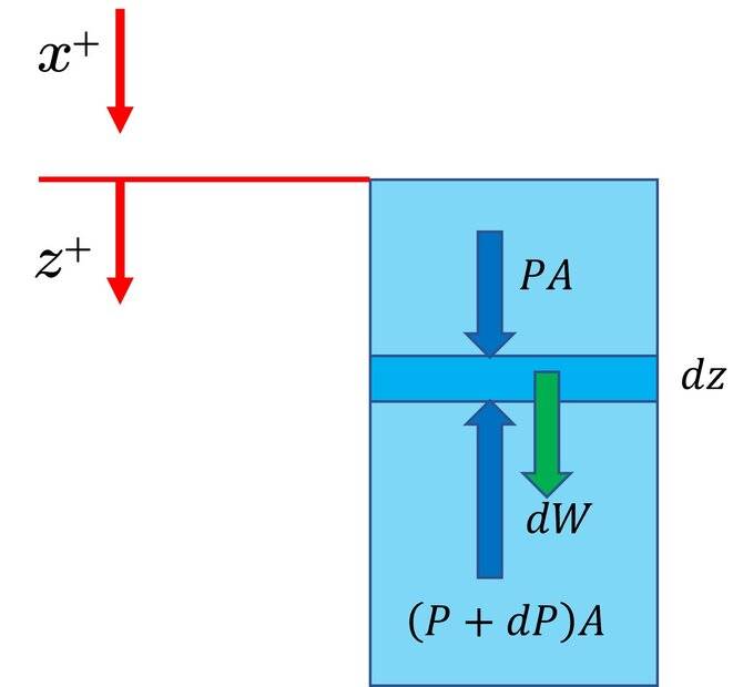

I would like to actually try to set up the equation for the leaking bucket on a spring, neglecting the fluid jet thrust and drag. I'm not fully understanding the result that was linked and was hoping someone would guide me through it.
Firstly, where do we take the coordinate from ##x## from? Does it matter? I have it shown from the ceiling the top of the cup.
The equilibrium position ## x_o## is a function of time:
Let
## M(t) = m_w (t) + m_b ##
$$ x_o (t) = \frac{ \left( m_b+m_w(t) \right) g}{k} =\frac{ M(t) g}{k} $$
Where:
## m_b## is the mass of the bucket
## k## is the spring constant
## m_w ## is the mass of the water in the bucket at time ##t##
Ignoring the thrust from the jet:
Is (1) the proper differential equation?
$$ M(t) \frac{d^2}{dt^2} \left( x- x_o(t) \right) = M(t) g - k \left( x- x_o(t) \right) \tag{1} $$
