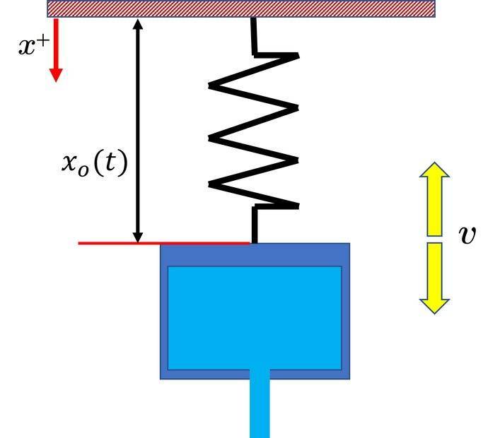

Okay so today I went to my prof., and I showed him how I approached the problem. We derived the same equations we got here together, and I asked him how he would go on to get the oscillation time. He said that I definitely need to solve this numerically, as someone already suggested.
He advised that I can use a program called Berkeley Madonna, and that I model a flowchart with my data, and how they interact with each other (e.g. mass with velocity etc.). Then to plot a graph, on which there would be both oscillations (constant vs. non-constant mass, at same initial conditions), and compare the periods, oscillation times, displacement and so on. Then to ''subtract'' the graphs and see where the main differences are.
Basically I shouldn't worry how to get a generalized equation, but to focus on the oscillation time for my specific experiment to get a solution.And again, thank you all for your contributions :)

erobz said:
For the draining cup the mass flowrate in the direction of motion is non-zero, and there will be an impulse in the direction of motion from the fluid jet.
So you think the term ##\frac{dm}{dt}\frac{dx}{dt}## is correct in equation of post #2? I just don't think so but I will come back on this tomorrow, now I got to go and try to sleep.

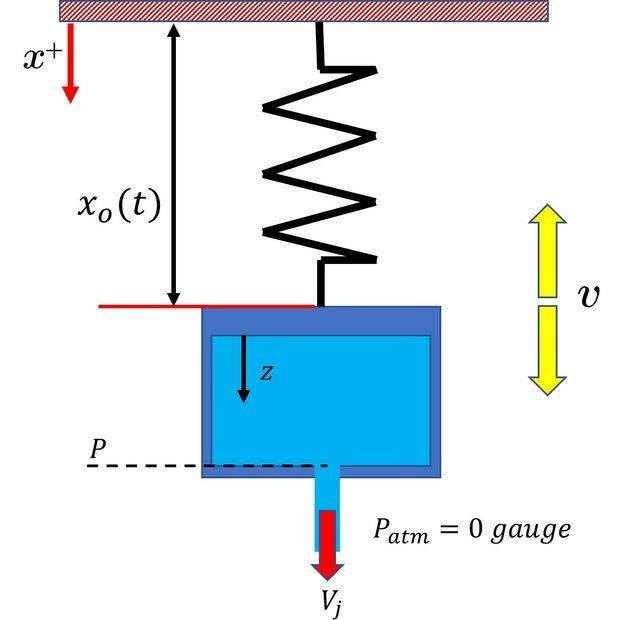

No, not exactly. There should ( or at least could ) be a thrust term, but not quite that. For this following example, its probably very small in comparison with the weight.
For the draining cup ##c## hanging from a simple string with tension ## T ## I don't see why the rocket equation wouldn't apply, but that doesn't mean that I'm not missing something. The oscillating cup has to be a completely different animal, but I think maybe start here?
Let ## M ## be the total mass
$$ M = m_c + m_w $$
Then
$$ \sum F = \frac{dM}{dt} v_{e/c} + M \frac{dv}{dt} = T - Mg $$
Without viscous effects , where ##v_{e/c}## is the velocity of the jet relative to the cup:
$$ v_{e/c} = \sqrt{2gz}$$
where ##z## is the height if the water in the cup
Also we see that:
$$ m_w = \rho A_c z $$
Where ## \rho ## is the density of water, and ## A_c## is the cross-sectional area of the cup.
Thus;
$$ v_{e/c} = \sqrt{ \frac{2g m_w}{ \rho A_c}} $$
It also follows that:
$$ \frac{dM}{dt} = \frac{d m_w}{dt} = -\rho A_h v_{e/c} = - \rho A_h \sqrt{ \frac{2g m_w}{ \rho A_c}} $$
Where ## A_h ## is the area of the drain hole.
Putting that all together I get:
$$ - \rho A_h \sqrt{ \frac{2g m_w}{ \rho A_c}} \sqrt{ \frac{2g m_w}{ \rho A_c}} + M \frac{dv}{dt} = T- Mg $$
$$ -2 g \frac{A_h}{A_c} m_w + M \frac{dv}{dt} = T - Mg $$
I'm pretty sure that in this particular example - a tank draining under gravity - is not going to "take off" i.e. ## \frac{dv}{dt} = 0 ##, and the tension force in the string is just less than the total weight of the cup and remaining water.
$$ T = Mg - 2 g \frac{A_h}{A_c} m_w $$
Does this seem reasonable?
