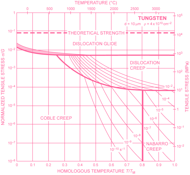

One of my thesis committee members, an outstanding metallurgist, taught me: "There is no such thing as elasticity, only negligible plasticity." Creep occurs in all materials at all temperatures; nothing is immune. Of course, the deformation is generally undetectable at less than a considerable fraction -- perhaps one-third or one-half -- of the absolute melting temperature.
  • Deformation-mechanism map for tungsten plotting normalized tensile stress against homologous temperature T/TM, with regions for dislocation glide, dislocation creep, Coble creep and Nabarro creep, and strain-rate contours from 10^-10 to 10^-2 per second.

The text does make such a point - "Although it is often convenient to think of a polycrystalline solid as having a well defined yield strength, below which it does not flow and above which flow is rapid, this is true only at absolute zero."
