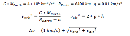

I am doing an assignment about launching a rocket and at the moment I am looking for the delta V of the rocket. I have done a few researches and i found a method of finding the energy of the rocket and find the delta vee of it , but then i found this article and I am not sure if it is delta vee or not, and i don't get why there is a 1km/s in the equation

∆v is the increase in speed while the main rocket burns
1 km/s must be the speed just before the main rocket starts to burn
(but i don't know where that comes from … it's over twice the Earth's rotation speed :confused:)
