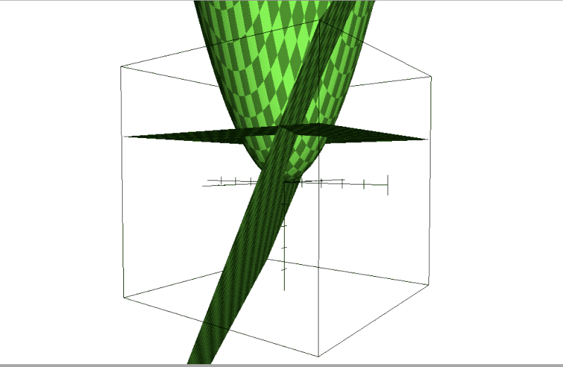

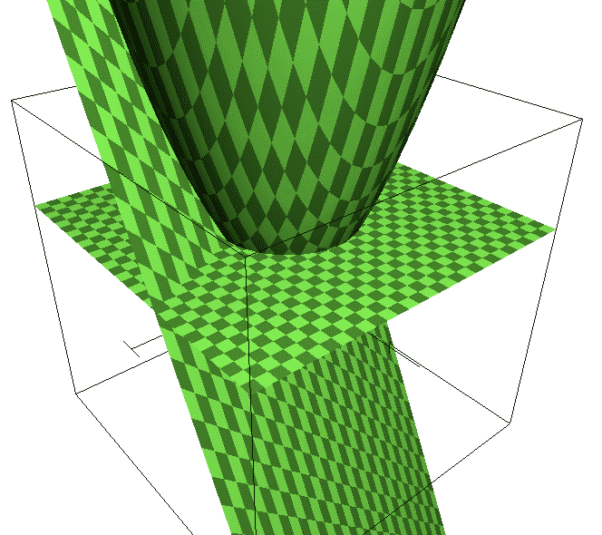

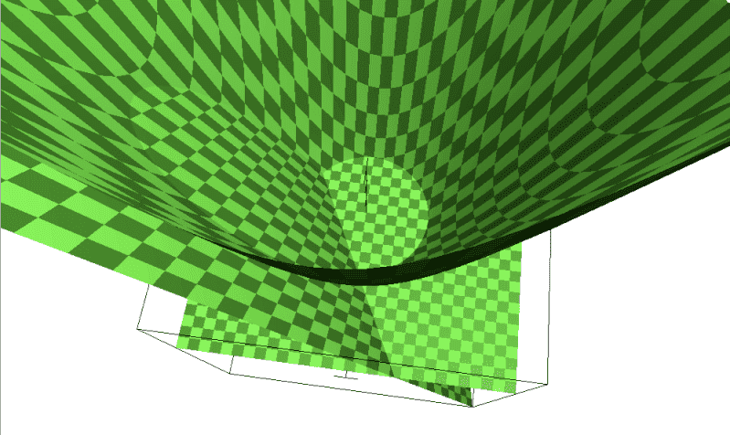

For anyone who is curious, I plotted T(x,y) = y + 2x and g(x,y) = x^2 + y^2 along with the plane z(x,y) = 1. The intersection of z(x,y,) = 1 with g(x,y) = x^2 + y^2 gives the level set g(x,y) = x^2 + y^2 = 1. Here are a couple of views:
3D plot in a bounding box of a green checkered paraboloid opening upward, a flat dark green plane cutting horizontally through it, and a second striped green sheet crossing diagonally through the scene, with thin black coordinate axes.
and another view
3D plot of a green checkered paraboloid cup-shaped surface intersecting a horizontal checkered plane, enclosed in a wireframe bounding box.
And and one more
Green checkerboard-textured 3D surface plot shown from below, forming a bowl-shaped paraboloid, with a flat checkerboard plane cutting through it and a thin black wireframe box beneath.

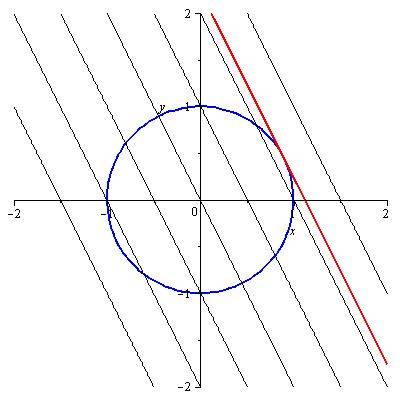

Pretty pictures, but I don't think they add to the understanding of what is going on. The example problem is given temperature T(x,y) = x+2y in the plane, find the hottest point on the wire represented by the unit circle x2+y2 = 1. The following plot shows the level curves for T varying from -3 to 3 including, in red, T =sqrt(5) which obviously gives the max.
Plot of parallel diagonal level lines with a unit circle in blue on x and y axes from -2 to 2, with the tangent level line in red touching the circle.
Maple doesn't label the contours, but in this example the y intercepts of the contour lines give T for the lines.
Different people learn in different ways I guess :smile: The picture that you drew is indeed the exact same picture that I drew originally, but I found that it did not add to my understanding of the problem.
For me the problem was that T(x,y) is in fact a surface, whether "it helps to interpret it that way" or not. And the constraint, though in this case is a simple circle, is actually a level set on a surface. So for me, being able to see that for the constraint
g(x,y) = x^2 + y^2 = anything,
T(x,y) is maximal when the level set of g(x,y) is tangent to T(x,y).
