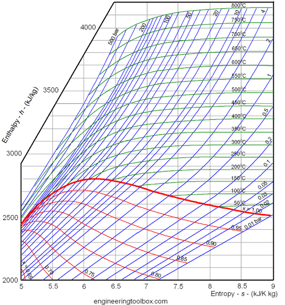

The reason it's called a saturation line is that when the thermo properties of water are presented in graphical form, a heavy line usually separates the superheated vapor region from the saturated vapor region. The saturation line is shown in red below:
The heavy red line where x = 1.0 is the saturation line, and x is the quality in decimal form. The lighter lines plotted below represent other quality lines (x = 0.95, x = 0.90, etc.) Above the heavy red line is the superheated vapor region.
