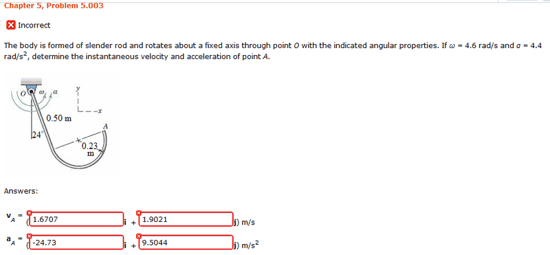

The body is formed of slender rod and rotates about a fixed axis through point O with the indicated angular properties. If ω = 4.6 rad/s and α = 4.4 rad/s2, determine the instantaneous velocity and acceleration of point A.
I have attached an image of the question
v = wXr
a = αXr + wX(wXr)
r = <0.5sin(24)i + 0.23cos(24)i +0.5cos(24)j - 0.23sin(24)j>
r = <0.4135i + 0.3632j + 0k>
w = 4.6k
va = <0i + 0j + 4.6k> X <0.4135i + 0.3632j + 0k>
VA = 1.6707i + 1.9021j
But it says this is wrong. What am I missing?
I know for the second part that I need to use:
aA = αXr + wX(wXr) but I can't seem to get wXr right.
Any advice would be greatly appreciated.
well I see that you are using 0.23m as the distance from the straight part of the rod to the point A. However, I think 0.23m is the radius of the cirular part of the rod, so then the distance you should be using would be the diameter 0.46m.
You are correct. Thank you. My final correct answers are:
V_A = 1.24i + 2.869j
a_A = -12.01i + 8.449j
