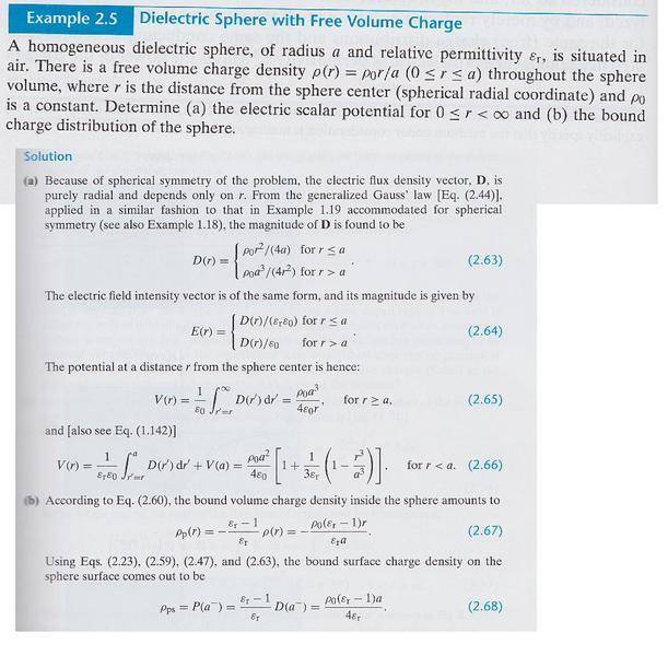

See figure attached.
I'm confused as to how they got their D(r)
Using Gauss' Law,
For r < or = a
\oint_{S} \vec{D} \cdot \hat{n} dS = \int_{v} \rho dv
D(4 \pi r^{2}) = \frac{\rho 4 \pi r^{3}}{3}
\Rightarrow D = \frac{P_{0}r^{2}}{3a}
What am I doing wrong?

You have ρ = constant. It's not.
