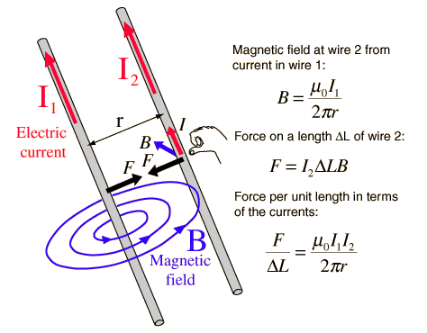

One of the design considerations is rigidity.
Under high current faults the conductors are attracted to one another,
so it is required they be stout enough that a downstream fault will not make them bend and touch between supports which would cause another fault.
So i'll assume your 40 and 50 ka numbers are fault current ratings,beyond the 1.25 ka.
Presumably the busbar is supported as necessary and made more rigid considering the forces produced by fault current. Those forces are in proportion to the product of the currents as indicated in that Hyperphysics image above, http://hyperphysics.phy-astr.gsu.edu/hbase/magnetic/wirfor.html
502/402 = 1.56+,
ie 56% more bracing required.
That of course raises the cost of busbar and breakers.
