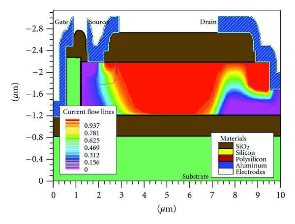

That's not a simple question. By the way, you have a 3D object, not 2D.
Semiconductor device designers consider exactly that question. For example:
There are also analytic methods as in
https://www.google.com/url?sa=i&sou...aw19xF9WbQbgd0CFFKQrv87b&ust=1576769471286070
If the external voltage is not constant in time, there are also eddy currents, surface currents, and transient solutions to consider. This is no simple answer to your question. I expect that many PhD theses have been written on that question.

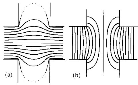

A point has no area so the resistance of a point contact is infinite. The current density at a point contact is also infinite. While voltage measurements can be made at points, the current density pattern in a resistive material must be specified between defined contact areas, not between point contacts.
Analytic solutions require restriction of the contact areas and boundary conditions to idealised geometry.
Electric field patterns and current flow in real-world bounded-solids are often solved using finite element numerical relaxation techniques.
