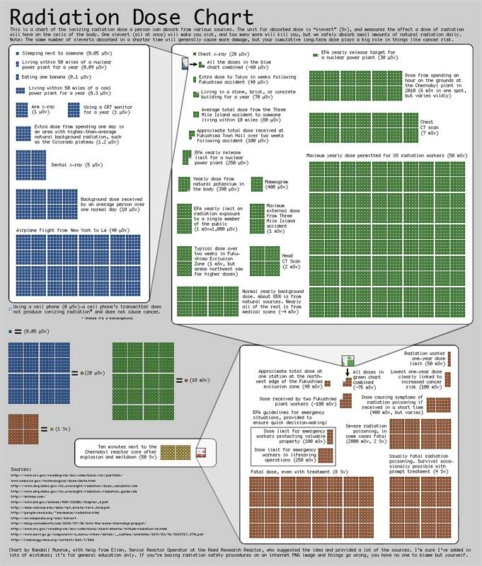

Here's an image of a Radiation Dose Chart.
Radiation Dose Chart: grids of coloured squares, each square representing a dose in sieverts, comparing everyday, medical, occupational and accident doses from 0.05 µSv up to 8 Sv.
Here's a larger image.
  • Radiation Dose Chart: grid of blue, green, brown and yellow squares, each square a set dose in microsieverts or sieverts, comparing everyday, medical, occupational and accident doses.
