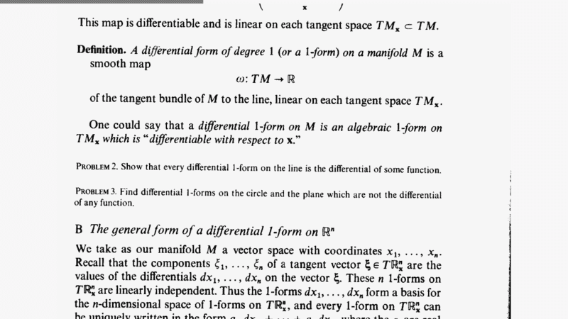

This problem is from V.I Arnold's book Mathematics of Classical Mechanics.
Q) Show that every differential 1-form on line is differential of some function
The differential of any function is
$$df_{x}(\psi): TM_{x} \rightarrow R$$
The tangent to line is line itself. The differential 1-form is ##dy-dx=0##. Here I am struct. I don't know how to find out the differential. Can anyone help?
No.
Abhishek11235 said:
The differential 1-form is dy−dx=0dy−dx=0dy-dx=0.
No. A general differential 1-form is of the form ##\omega = g(x) dx##. You have to show that there exists a function ##G(x)## such that ##\omega = dG##.
Orodruin said:
No.No. A general differential 1-form is of the form ##\omega = g(x) dx##. You have to show that there exists a function ##G(x)## such that ##\omega = dG##.
That means I have to integrate. Can you provide me solution?
That would violate the forum rules, which you would realize if you had bothered reading them.
