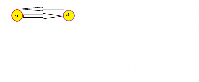

There is charge ##q_0## which is fixed.from a distance far away another charge ##q_1## is fired towards it with speed ##V_0## then we know as both of these are positive charges these will repel each other as the charge ##q_1## comes closer. While coming closer to ##q_0##, it's speed decreases and after reaching a closest distance ##r_0## it's speed becomes zero . Now this is the position when , both of these charges will be at rest and there won't be any kinetic energy in ##q_1## left at this position.
My first question is how charge ##q_0## must have been fixed such that it does not move due to repulsion?
I'm not sure, but one way to do this would be putting the charge q0 on a spherical shell (non conducting) such that it uniformly distributes over it. This way, the charge q0 will be fixed on the shell as q1 approaches it.

Ok.We consider a charge ##q_1## which is again fixed, and always kept at rest. and from this charge particle at an impact parameter d another charge, which is having mass m and charge ##q_2## is thrown with the speed ##V_0##. We know that as the charge ##q_2## gets closer to. ##q_1## due to repulsion it's path will be deviated .We wish to find out the distance of closest approach of the 2 particles.I have read that
distance of closest approach will be at a position when the velocity vector of. the charge ##q_2## will be at right angle to the line joining ##q_1##and ##q_2##
I want to know why ?

Solving the equation of motion, you will see that elastic collision due to Coulomb repulsion yields a hyperbolic trajectory of the moving body. You should be able to see intuitively that the closest distance occurs when the velocity vector is perpendicular to the position vector of ##q_2##.

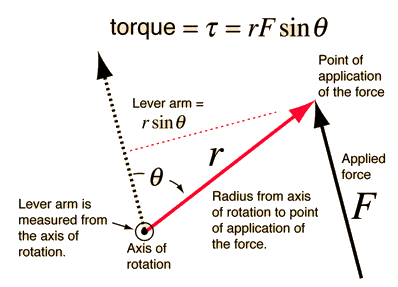

And then
We can use angular momentum conservation as the electric force won't apply any torque with respect to the charge ##q_1## in the whole system
Please help me to understand this line.
Do you know the definition of angular momentum and in what conditions will be conserved?
It is the product of its moment of inertia and its angular velocity.
When there is no torque.
