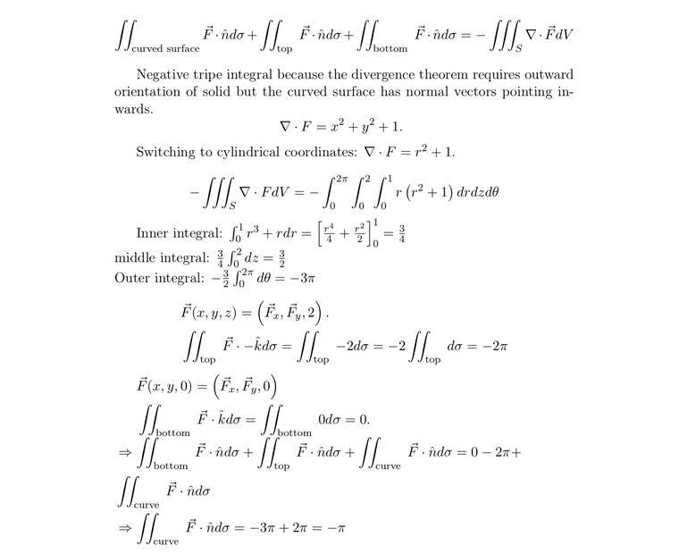

Question involving the Divergence Theorem and Surface Integrals
lys04
144
Divergence theorem problem
Divergence theorem, surface integrals
Is this correct? Ignore my bad drawings
It looks fine, but in the future please do not simply post images. The forum has a perfectly functioning LaTeX implementation, use it! If you just post a screenshot of your compiled math there is no possibility for us to quote particular sections of your post and it is less readable.
Will do! Thanks
