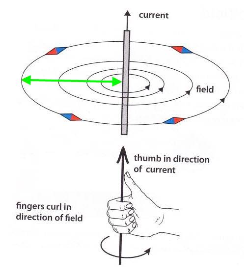

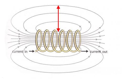

Hi,
I wanted to clarify a point about the magnetic fields of a solenoid and wire. Do the fields extend to infinity? In my opinion, they don't but they can assuming the current also goes to infinity. They don't extend to infinity for a limited amount of current because they need to follow a closed path. But in the case of a single charge the field does extend to infinity. In the case of two oppositely charged bodies, again the fields don't extend to infinity.
Could you please confirm if I have it correct? Thank you!
  • Diagram of a solenoid with current in at the left end and current out at the right, showing concentric magnetic field lines looping around and through the coil, with a red double-headed arrow marking a distance above the coil.
  • Diagram of the right-hand rule for a current-carrying wire: a vertical wire with current arrow pointing up, concentric circular field lines with arrows around it, a green double-headed arrow across the field, and a hand with thumb up along the current and fingers curled in the field direction.

The fields usually extend to infinity even if the sources (current densities sources or charge densities sources) are finite. The fields intensity drops according to ##1/r## or ##1/r^2## or ##1/r^3## where r is the distance from the source. There might be some large value of r for which the fields become too weak, but theoretically ##1/r## never becomes zero for any value of r. So in all four cases you mention in your pictures, the fields theoretically extend to infinity.
The fact that the field lines might form closed curves (which happens in 3 of your pictures, the finite solenoid, the finite wire and the two charges) or might be straight lines (which happen in the case of the single point charge) has nothing to do with whether the fields extend to infinity or not.
The only exception to this is when there is some sort of conducting structure that acts as shielding and prevents the fields from extending to infinity. Such a shielding can be for example for the point charge , a thin spherical conducting shell of any radius that encloses the point charge in its center.

I have another question about the magnetic field of solenoid and wire. A solenoid is an inductor which stores its energy in the form of magnetic field; a wire also acts like an inductor with very small inductance. When the current stops flowing through the inductor, its magnetic field collapses and energy is released. If DC current has been running through inductor for some time, its field might have extended beyond the reaches of solar system. So, shouldn't it take some noticeable time for the collapsing field to return energy to the inductor? Practically, the energy is returned instantaneously. I think a big portion of energy is returned instantaneously and remaining some unnoticeable infinitesimal portion might take longer.
Thanks a lot for you help!
