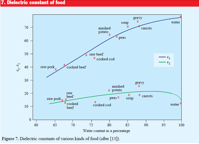

Hello there . That's an interesting question . In my opinion :
What's important to realise in first place is that there's no heat transferred to food ( you really don't have any heat flowing ). I get what you mean , but it's important to realise why it's wrong to talk about heat transfer , because this insight will help understand the answer to your question better .
What the microwave oven does is to fill it's inner space with standing EM waves ( the oven chamber acts like an EM cavity ). When you put food inside this cavity you basically force food's molecules to vibrate due to the oscillating EM field inside the cavity . The vibration of food's molecules results in heat production .
An important detail here is that not all molecules can actually vibrate . At least not as much as others . The molecules should pocess a property called dipole moment . In very simple terms there should be separation of a positive and a negative charge ( could also be induced to some degree by the field itself if not inherent to the structure of the molecule )* .
So yes , the content of the microwave oven definitely affect whether the object will be heated and if energy is going to be drained from the cavity . Therefore...
If a full mug of milk takes 1 minute to warm at 900W , then you should place both mugs in the oven for just 1 minute . The energy is there , in the cavity . Placing a second mug of milk won't affect the heating of the other mug . You are just draining more energy from the EM field which is already stored in the cavity .
*Conductive materials can also heat in the oven . Extremely fast to be honest , so you have to be extremely careful and never , ever put something conductive in a microwave oven like for example aluminum foil .

It is not necessary to have a resonance in the box for a magnetron to supply energy to food. When you switch on, the resonant energy builds up to a maximum over many cycles. When you switch off, the box then supplies energy to the load and to the magnetron over many cycles. When the magnetron supplies energy to food, a travelling wave goes from the magnetron to the food. Resonance can be useful to provide transformer action but is not fundamental to microwave heating.
