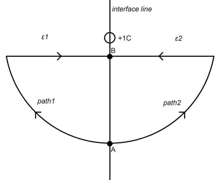

Does path independence still hold if permittivity is non-uniform
Diagram of two half-spaces separated by a vertical interface line, labelled ε1 on the left and ε2 on the right. A +1C charge sits on the interface at point B above a point A on the line below; two arc paths, path1 and path2, connect A and B through each half-space.
Consider a scenario in the picture where one half of space consists of a material with permittivity ϵ1 and the other half consists of a material with permittivity ϵ2, where ϵ1 > ϵ2. A unit positive charge is fixed at the interface between the two materials. Path1 is entirely within the material with permittivity ϵ1 and Path2 is entirely within the material with permittivity ϵ2. The paths are reflectively symmetric, with the interface acting as the mirror line. Just for simplicity, also assume the arc part of the both paths is perpendicular to the electric field comes from the fixed charge so they don't contribute to the work. Does it still require the same amount of work to move a unit positive charge from point A to point B along Path1 and Path2?
$$W=\int_{A}^{B}\overrightarrow{E}\cdot\overrightarrow{dl}$$
where $$\overrightarrow{E} = \frac{1}{4\pi\epsilon r^2}\widehat{r}$$
  • Diagram of a vertical interface line with a horizontal line through point B, a point charge +1C drawn on the interface above B, regions labelled ε1 (left) and ε2 (right), and a semicircular arc through point A below, labelled path1 on the left and path2 on the right.

I think that work would be different for both sides.
The work is the same for both paths. It turns out that the electric field is given by the same expression in both dielectrics: $$\vec E = \frac{q}{2\pi(\epsilon_1+\epsilon_2) r^2} \hat r,$$ where ##r## is the distance from the charge ##q## and ##\hat r## is the unit radial vector pointing away from ##q##.

Yes, it can be easily shown that path independence holds for this particular case. Label the half space containing ##\varepsilon_{1}## as Region 1 and that of ##\varepsilon_{2}## as Region 2. Erect a spherical coordinate system ##r,\theta,\phi## centered on the charge ##Q## and aligned such that the interface between regions 1 and 2 is the ##x,y## plane, i.e., where ##\theta=\pi/2##. In both regions, the electric field satisfies Coulomb's Law: $$\nabla\cdot\overrightarrow{E}=0\Rightarrow\overrightarrow{E}\left(r,\theta,\varphi\right)\propto\frac{\hat{r}}{r^{2}}\Rightarrow\overrightarrow{E}_{1}\left(r,\theta,\varphi\right)=\frac{k_{1}}{r^{2}}\hat{r},\quad\overrightarrow{E}_{2}\left(r,\theta,\varphi\right)=\frac{k_{2}}{r^{2}}\hat{r}$$In addition, the tangential component of ##\overrightarrow{E}## at the dielectric interface must be continuous:$$\overrightarrow{E}_{1}\left(r,\frac{\pi}{2},\varphi\right)=\overrightarrow{E}_{2}\left(r,\frac{\pi}{2},\varphi\right)\Rightarrow k_{1}=k_{2}\equiv k$$In other words, the electric field ##\overrightarrow{E}_{1}=\overrightarrow{E}_{2}=\overrightarrow{E}## has the single functional form ##\overrightarrow{E}=k\,\hat{r}/r^2## throughout all space. The constant ##k## can easily be found by applying Gauss's law to a spherical surface surrounding ##Q##, one hemisphere in Region 1 and the other in Region 2, with the result:$$k=\frac{Q}{4\pi\overline{\varepsilon}}\Rightarrow\overrightarrow{E}=\frac{Q}{4\pi\overline{\varepsilon}r^{2}}\hat{r}\quad\text{where}\;\overline{\varepsilon}\equiv\frac{1}{2}\left(\varepsilon_{1}+\varepsilon_{2}\right)$$Thus, a charge ##Q## located at the interface between two dielectrics gives rise to a uniform coulomb field of exactly the same form as if the charge were embedded in a single medium with the average dielectric. Hence, the work done on transporting a test charge is path-independent.
If the charge is a point, how can it be simultaneously in both dielectrics?
The two path integrals of E must be equal because the potential at B must be the same for each path.

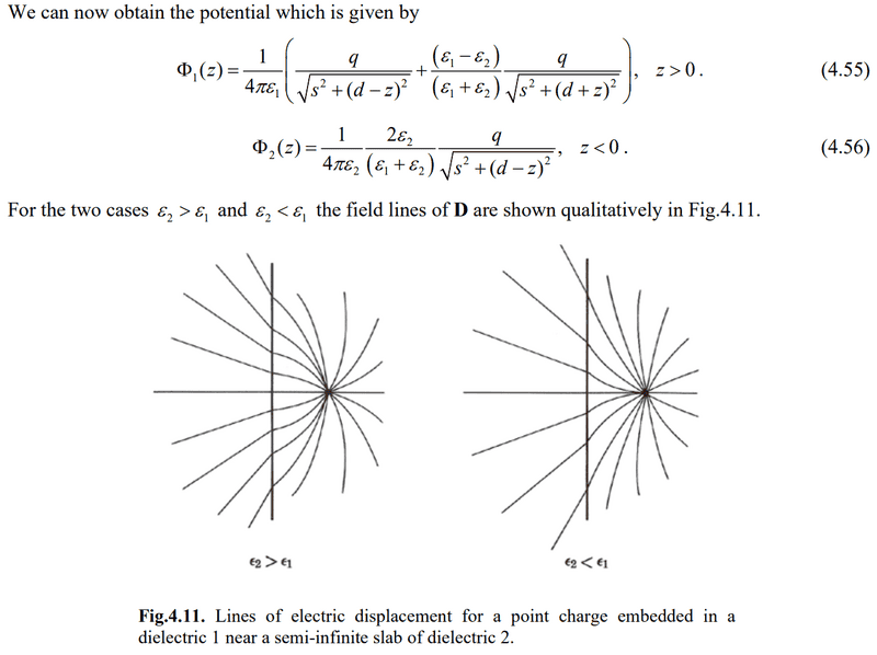

Again, I claim this is entirely wrong.
The following reference: https://unlcms.unl.edu/cas/physics/tsymbal/teaching/EM-913/section4-Electrostatics.pdf solves for the electrostatic potential ##\Phi## due to a point charge ##q## standing-off at a distance ##d## from a planar dielectric interface. It uses the method of images and works in cylindrical coordinates:
Two diagrams of a point charge q near a planar dielectric interface: left shows the interface as a vertical line with permittivity e2 on the left and e1 on the right, and the charge q at distance d from it; right shows the image charge q' at A' and charge q at A, with distances R2 and R1 to point P above the interface.
The result is:
Two diagrams of electric displacement field lines for a point charge at the interface of a semi-infinite dielectric slab, with curved lines bending toward or away from the vertical boundary; left labelled ε2 > ε1, right labelled ε2 < ε1.
Our interest is the case where ##q## resides exactly on the interface, so we set ##d=0## to find:$$\Phi_{1}\left(z\right)\left|_{d=0}\right.=\Phi_{2}\left(z\right)\left|_{d=0}\right.=\frac{q}{2\pi\sqrt{s^{2}+z^{2}}\left(\varepsilon_{1}+\varepsilon_{2}\right)}=\frac{1}{4\pi\overline{\varepsilon}}\frac{q}{r}\:\text{where }\overline{\varepsilon}\equiv\frac{\varepsilon_{1}+\varepsilon_{2}}{2}$$Therefore, the electric field is:$$\overrightarrow{E}\left(r\right)=-\nabla\left[\frac{1}{4\pi\overline{\varepsilon}}\frac{q}{r}\right]=\frac{1}{4\pi\overline{\varepsilon}}\frac{q}{r^{2}}\mathbf{\hat{r}}$$which is precisely the solution from my post #4 that exhibits straight E-field lines in the radial direction.
If you still assert otherwise, the burden is on you to post either your own derivation or else a scholarly reference that obtains the solution in terms of multipoles and manifests curved E-field lines.

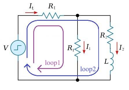

I want to confirm I understand path independence correctly in circuit analysis. In the circuit below, since for loop1, we have $$\oint_{closed}^{}\overrightarrow{E}\cdot{d}\overrightarrow{l}=-V+I_tR_t+I_1R_1=0$$
and for loop2 we have $$\oint_{closed}^{}\overrightarrow{E}\cdot{d}\overrightarrow{l}=-V+I_tR_t+I_2R_2= -L\frac{dI_2}{dt}\neq0$$
so that's why we say it is path dependent right?
Circuit schematic with a voltage source V on the left, a resistor R_t on top carrying current I_t, a middle branch with resistor R_1 carrying I_1, and a right branch with resistor R_2 in series with inductor L carrying I_2. Two loops are traced: loop1 in purple and loop2 in blue.
Yes, that's right. The time-dependent B field of the inductor makes ##\oint^{}\overrightarrow{E}\cdot{d}\overrightarrow{l}## path dependent.

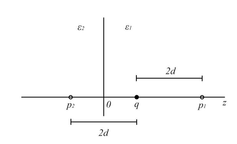

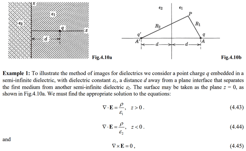

I look into the example 1 in this reference and I find something that bothers me a little bit.
When I try to find potential and electric field at the point 2d distance away from the q charge in both dialectrics ε1 and ε2 on the z-axis(s=0), i.e.: p1 and p2 in the following picture. I got for p1
Diagram of a point charge q on the z-axis at distance d from the interface at z=0, with permittivity epsilon 2 on the left and epsilon 1 on the right; image charge positions p2 and p1 are each marked 2d from q.
$$\\\\\Phi_{1}\left(z\right)\left|_{s=0,z>0}\right.=\frac{1}{4\pi\varepsilon_{1}}\left(\frac{q}{d-z}+\frac{\left(\varepsilon_{1}-\varepsilon_{2}\right)}{\left(\varepsilon_{1}+\varepsilon_{2}\right)}\frac{q}{d+z}\right) \\\\E_{1}\left(z\right)\left|_{s=0,z>0}\right.=-\nabla\Phi_{1}\left(z\right)\left|_{s=0,z>0}\right.=-\frac{d\Phi_{1}\left(z\right)\left|_{s=0,z>0}\right.}{dz}=\frac{1}{4\pi\varepsilon_{1}}\left(\frac{\left(\varepsilon_{1}-\varepsilon_{2}\right)}{\left(\varepsilon_{1}+\varepsilon_{2}\right)}\frac{q}{\left( d+z \right)^{2}}-\frac{q}{\left( d-z \right)^{2}}\right) \hat{z}$$
assume q is a positive unit charge so
$$\\\\E_{1}\left(z=3d\right)\left|_{s=0,z>0}\right.=\frac{1}{4\pi\varepsilon_{1}}\left(\frac{\left(\varepsilon_{1}-\varepsilon_{2}\right)}{\left(\varepsilon_{1}+\varepsilon_{2}\right)}\frac{1}{16d^{2}}-\frac{1}{4d^{2}}\right) \hat{z}$$
Since the term inside the bracket is less than 0, the electric field at z=3d is pointing toward the unit positive charge which seems wrong?
and for p2
\Phi_{2}\left(z\right)\left|_{s=0,z<0}\right.=\frac{1}{2\pi}\frac{1}{\left(\varepsilon_{1}+\varepsilon_{2}\right)}\frac{q}{d-z}
\\\\E_{2}\left(z\right)\left|_{s=0,z<0}\right.=-\nabla\Phi_{2}\left(z\right)\left|_{s=0,z<0}\right.=-\frac{d\Phi_{2}\left(z\right)\left|_{s=0,z<0}\right.}{dz}=-\frac{1}{2\pi}\frac{1}{\left(\varepsilon_{1}+\varepsilon_{2}\right)}\frac{q}{\left( d-z \right)^{2}}\hat{z}$$
again assume q is a positive unit charge so
$$\\\\E_{2}\left(z=-d\right)\left|_{s=0,z<0}\right.=-\frac{1}{2\pi}\frac{1}{\left(\varepsilon_{1}+\varepsilon_{2}\right)}\frac{1}{4d^{2}}\hat{z}$$
Electric field at z=-d is pointing away from the unit positive charge so it is correct.
$$\\\\\Phi_{1}\left(z\right)\left|_{s=0,z>0}\right.=\frac{1}{4\pi\varepsilon_{1}}\left(\frac{q}{d-z}+\frac{\left(\varepsilon_{1}-\varepsilon_{2}\right)}{\left(\varepsilon_{1}+\varepsilon_{2}\right)}\frac{q}{d+z}\right)$$
The denominator of the first term should represent the (positive) distance from ##q## to the point on the z-axis where you are evaluating the potential in medium 1.
So the denominator should be written ##|d-z|## instead of ##(d-z)##. In the neighborhood of ##p_1##, ##z > d##. So, ##|d-z| = z-d##.
