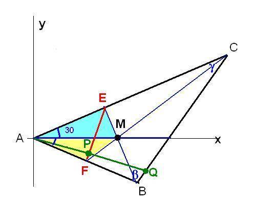

Let ABC be a triangle in which angle A = 600. Let BE and CF be the bisectors of the angles B and C, with E on AC and F on AB. Let M be the reflection of A in the line EF. Prove that M lies on BC.
http://img135.imageshack.us/img135/606/sumu.png
I didnt really get this problem...i was led to make assumptions and then solve, but that is wrong, i believe.
So can you please help me out?

For an equilateral triangle the solution is simple. The incenter coincides with the circumcenter, orthocenter etc and thus EF is parallel to BC with E and F being the mid points of their respective sides. Thus, the reflection of A from EF will lie on BC and will be the mid point of BC. I'm just thinking of how to prove this for a more general case.
One really long, but general method to prove or disprove this would be to assume that the point A lies on the origin. Let the point B lie on the X axis and its coordinates be (x1,0).
As we know the angle A is 60 degrees, the equation of the line AC comes out to be y=\sqrt{3} x and the point C has coordinates x_2, \sqrt{3} x_2.
The line BE thus has the equation y=\frac{1}{\sqrt{3}} x.
The long winded part is finding the points of intersection of these two line to get the points E and F, thus to get the equation of EF and to find the reflection of A. If this lies on the x-axis then its proven, otherwise not.
There should be a geometrical solution for this which is much simpler, however, the above solution should also work albeit with a considerable amount of work.

I got it at last. See the picture. Let be β=60-δ and γ=60+δ. The point M is the centre of the incircle. Let be the distance AM=1. Find the angles around M and everywhere in terms of δ, and apply the Sine Law for the yellow and blue triangles to find the lengths AE and AF. Find the coordinates of E and F. Find the tangent of the line EF. Find the angle its normal encloses with the x axis. Find AP and AQ, using the Sine Law again.
ehild
ehild
But is doing such an assumption correct?
Why not? The mirror image stays on the opposite side if you blow up that triangle. Instead of starting from the sides of the triangle, I start with AM. All the other lengths including the sides of the triangle are proportional to it.
ehild
okay, thank you.
This can be generalized too, like taking AM=x.?
Of course, you can call it anything. You can express all lengths in terms of this x and delta. All lengths are proportional to this x, which cancels at the end when finding the ratio AQ/AP.
ehild

Here is a solution i found in the answer key.
In the figure : http://img692.imageshack.us/img692/5837/sumo.png
AFIE is cyclic. Circle AFC cut BC at D. (BF. BA)=(BI.BE)=(BD. BC). IDCE is
cyclic, angle EIC = angle EDC=60°.
ABDE is cyclic. AF=FD, AE=ED (angle ACF = angle FCD, Ð ABE = Ð EBD). AFDE is kite.
Thus, D is the mirror of A in EF.
Which property is this?
