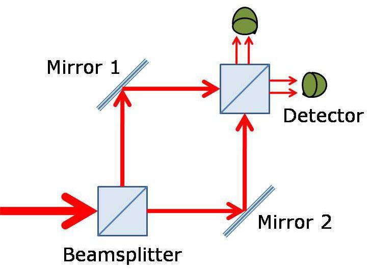

The mirror doesn't slice the photon in half, but sends it on its way to A or B. However, in case of this setup:
Diagram of a Mach-Zehnder style interferometer: a beam enters a beamsplitter, splits into two paths reflected by Mirror 1 and Mirror 2, and recombines at a second beamsplitter feeding two green detectors.
since only the right detector detects a photon due to interference of the two photon paths (M1, M2), the photon seemingly (in my mind) is sliced in two in order to interfere with itself. But this slicing is not possible since the irreducability of a particle, hence the way out using superposition?
I don't think either of these is a good description. The mirror creates a superposition of |A> and |B>.

So is it correct that this setup should be discussed in terms of states/wavefunctions instead of in terms of 'photons'?
mfb said:
It should be discussed with states of photons.
If the photon takes both paths, in order to be able to interfere with itself, then what is 'traveling' along both paths exactly? Two full photons or two half photons?
Neither.
A state with a given amplitude. To understand the system you have to consider the whole state - the superposition of both paths.
