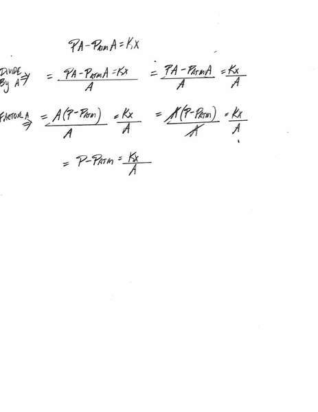

Let's stay with the original equation. We have;
PA - P atm A = K spring, change in X.
Notice the equation above is like a see saw where the pivot is the equals sign "=". On the left hand side we have; PA - P atm A. And on the right hand side we have; K spring, change in X
Now if we wish to divide both sides of this equation by "A", then we must add "A" to both sides. By doing this we get;
A A
By the above equation if we now cancel the like terms on the left hand side, "A" numerator will cancel with one "A" the denominator, which will leave a remainder;
P - P atm A = K spring, change in X
A
So that if we put our data into this new equation, we get a new result which is not the same as the original = 0.818m. In the above example the answer given is; 0.643m
Hope this helps
PS. the forum platform shows the "A"s to be at the far left, these denominators should be on each side of the equals sign, ie. A = A, not AA on the left?
David:smile:

Hi David! :smile:
(just got up :zzz:)
Let's just put that into CODE tags to preserve the spacing: :wink:
Code:
[U]PA - P atm A[/U] = [U]K spring, change in X[/U]
         A                   A
P - P atm A = [U]K spring[/U], change in X
                A
ok, now I see what you've done … you've only "cancelled" one of the As on the LHS …
you can't do that! … you must "cancel" both of them:
(PA - PatmA)/A = P - Patm
that's how brackets work! :smile:
I hope this helps... :)
                A

Show us how exactly you get a different solution.
Sorry...for my earlier reply...but .2 is the answer if .05 in diameter...which I took wrong in earlier reply...the ans is .818=.0245*4...
So I guess he also was getting a different answer because he was takin it as diameter while calculation...just 1 of the silly mistakes...
soory/...I think that above reply was really late to make some sense..actually I read the 1st page and replied...srry
