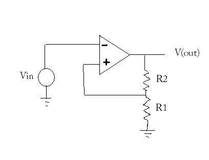

I have a very basic doubt in schmmit triggers...suppose if I connect the required power supplies to the op-amp (ie. V+ and V-) and make the desired connections(see attached circuit). Now, what would be the output when Vin=0, ie. before the signal is applied.
It could be on or off as the initial input condition isn't specified. It's normal to use a pull-up or pull-down resistor (either explicitly or by virtue of what's in the previous stage) to define the output state at switch on.

The starting output condition is indeterminate in this case. It will depend on the exact OPAMP used and the initial transient conditions when starting. The output may be near V+ or near V-.

so how would i know what would be the output at starting?
actually, i want the comparator to give a high signal only when the input signal (which is always positive but of very small magnitude) is applied. Before the application of input signal, the output must be low..
can you please suggest me a circuit or modifications for the same?
By defining the input volts at startup. But what is your input? What range of Volts are we dealing with? If that is well defined then the output state of the Schmitt is defined also. The Hysteresis of the circuit needs to be appropriate for the range of the input signal - enough to commit it in one direction or the other yet no so big that the input signal can't change the output. (This is set by the values of R1 and R2) The '+' input needs to have two states - separated by less than the '-' input signal swing but by more than the 'irrelevant' variations in the input signal, which you want to suppress.
Does the circuit use V+ and V- supplies? If not, then you may need to shift the input signal volts to somewhere around half the supply volts.
Your question is too undefined to make any concrete suggestions. Have you any experience with these things or is it your first involvement with Electronics?
Like all electrical circuits, it could be metastable. The output could be high, it could low, or it could balance at zero for a while (metastable).
Place a pencil with an eraser on a table. Now hit the pointed end so it ends up standing on the eraser for a while. It doesn't happen very often, but if you do in enough times, the pencil will stand on the eraser. Do it enough times and you will see it balanced for a long, long time. This is the metastable state.
Say you have an operational amplifier or comparitor with two independ signals into the + and - inputs. Eventually the two will arrive an nearly identical times, and the output of the device will not switch fully from high to low, or low to high, but hang in the middle. This is metastable hang.
Now look at the specific question you asked "suppose if I connect the required power supplies to the op-amp (ie. V+ and V-) and make the desired connections(see attached circuit). Now, what would be the output when Vin=0, ie. before the signal is applied."
First, there is always a signal applied whether it be external or feedback. What was it before it was Vin=0. Was it an open circuit?

The signal Vin is initially open circuited. I want an output of 5V when the signal is applied(Vin would be the range of 5mv)
Now you are contradicting yourself. First you said Vin=0, now you say Vin is open circuited. There is a big difference between the two. You don't want to leave an input of an opamp open circuited, because a DC path must be maintained. Even though there is very high input impedance and the input current is negligible, the DC path must be there. You can place a 100K or 1M resistor from the input to ground or to one of the power supplies (if your opamp is capable of being driven to the rails on the inputs). If you tie to one of the supplies then your startup problem will no longer be there.
Also, Vin of 5 mV is very small and it is not easy to get a comparitor working in this range. Great care must be taken.
If you have as little as 5mV between the two states of the input signal then you need very little positive feedback or the Schmitt will never be pulled from its original state. Say R2 = 100KR and R1 = less than 20R. (depending on your output voltage swing).
Why not amplify your input signal by a factor of 100 before you go into the Schmitt?

i can't understand why the schmitt won't work...
if i assume that initially the output is at +V(sat)...the triggering point would be at
+V(sat)*R1/(R1+R2). So as u said if R2=100Kohm nd R1=20 Kohm, then triggering voltage would be around 1mv...this is lower than my signal...so why won't the schmitt work?
is there any other consideration also here?
The absolute level of your 5mV, perhaps?
Try a range of input voltages. Can you get it to change polarity with any input signal? If not, there's something really wrong, I think. Check that both rails are working. What voltage is on the + input?. Are both supplies connected? Are the right pins connected to the right signals? (I'm clutching it straws here but I've done my share of daft things when building circuits so don't be offended)
Well yes! Most definitely noise is the other consideration. Your signal level is not much larger than typical noise levels. Noise is one of the reasons why Schmit triggers are used in the first place. You want your trip-point voltage difference due to hysteresis to be larger than your noise level to prevel oscillations and false triggering. Like I said above, getting a comparitor to work at these voltage levels is not easy. The suggestion above to amplify your signal first is worth a try.

elect eng is so right when he talks of noise as being a possible problem. If you only need a bandwidth of a few tens of Hz then take your original signal pass it through an op amp filter with a gain of a few hundred at DC and put a capacitor in the feedback loop to bring the gain down after, say 50Hz. Then you will have a sensible level, low frequency, clean' signal for your Schmitt to look at. You can use a chip with two op amps on it so it won't take up much room.
Why use an amp plus the Schmitt? The Schmitt, being non linear, has a hard job to do the amplification and the decision making all in one go. The op amp can do some tailored filtering at the same time, too. Ideally, I guess you could say that the one circuit could do it all but the noise consideration (plus actually getting it to work) makes adding an op amp a better bet.
What is the source of your 5mV signal, btw?
Shikhar, you still haven't specified enough about your input source.
Why is it open circuit when inactive. Is it swiched, if so what type of switch? What impedence is the input signal, where does it come from etc?
You don't seem to understand that you cannot design this system without more info about the nature of the input signal.

actually the 5mV signal is from a photodiode which i have used to detect the light during a bomb explosion. When the explosion takes place, the photodiode gives a current which when passed through a small resistance gives a voltage of about 5mV. I want this voltage to trigger a switch for which i require 5V. Thus, frequency is not much of a problem for me. I jst need a fast response circuit.

Why don't you try R2=100 kohm, and R1=20 ohms, rather than R1= 20 kohms.?
Bob S
Bob S
sorry to all..actually i wanted to write 20ohms not 20Kohms... o:)
Hello Shikhar,
I see your problem, but I also agree with the other posters that 5mV is uncomfortably low, as it is the same sort of order of magnitude as the random offsets associated with many op-amps. You could increase the input voltage simply by increasing the photodiode load resistor, so try this first. This will however increase the RC time constant of the input circuit, possibly giving too slow a response.
If this is the case, one possible solution might be to use a TRANSIMPEDANCE circuit around the photodiode. Try doing a Web search on this subject, and see this link to some notes by TI: - http://focus.ti.com/lit/an/sboa055a/sboa055a.pdf Note that TIs example shows the photodiode with zero bias, which is correct if you want to minimise the effect of the dark current. On the other hand, a faster response should be possible with some bias applied - in Fig.1 of the example, the side of the photodiode shown grounded would be biased negatively.
