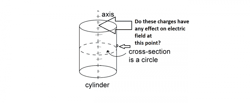

About Electric field due to an infinitely long straight uniformly charged wire my book says the assumption that the wire is infinitely long is very important because without this we can not take vector E to be perpendicular to the curved part of the cylindrical gaussian surface.I think it should be parallel in place of perpendicular or it should be flat part rather than curved part.
I also want to ask there is one more sentence that I am not getting
the expression of E derived from an infinitely long straight uniformly charged wire i.e Vector E= λ/2πε0r
is true largely at the central portion of the wire length and not really true at the ends of wire.I want to know why this is so?

No, it means perpendicular to the curved part, although I prefer to think of this as perpendicular to the axis of the cylinder i.e. the wire. This diagram and explanation works for me.

An infinitely long wire doesn't have ends. This is important because it means that we can ignore what happens at the ends thus providing the symmetry which makes it inevitable that ## \vec E ## is perpendicular to the axis.

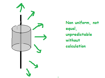

Only if the wire is infinitely long, the field will be a function of only the distance ("r" in cylindrical co-ordinates) from the wire,otherwise as the formula of Electric field at any point says it also depends on amount of source charge.
MrAnchovy said:
If the cylinder has finite length then in general a point on its surface is closer to one end than the other.
This makes different amount of source charge to be at different distance .Thus making field different at most of the points.
But when we take the wire to be infinitely long, we can picture the field as being a function only of the distance ("r" in cylindrical co-ordinates) from the wire, the farther from the wire, the weaker it is. The loci of all points of any constant field strength we choose/select will be a cylinder with a central axis on the wire.
Right?

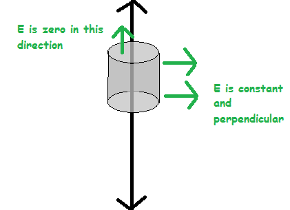

Good approach ! Both lazy physicists and good physicists always keep their eyes open for symmetries :smile:.
The case cries out for using cylindrical coordinates ##\rho, \phi, z##
In this case there are at least four symmetries in evidence
1. rotational -- same situation when replacing ##\phi## by ##\phi + \alpha ## with a constant ##\alpha\quad \Rightarrow \quad ## no ## \phi ## dependence
2. translational -- same situation when replacing ##z## by ##z + p ## with a constant ## p \quad \Rightarrow \quad ## no ## z ## dependence
3. reflection -- same situation when replacing ##\phi## by ##- \phi ## in combination with #1 ## \Rightarrow \quad \phi ## component is zero
4. reflection -- same situation when replacing ##z## by ## -z ## in combination with #2 ##\Rightarrow \quad z ## component is zero
In short: Yes. (to your last question)

When the wire is of infinite length
when it has a finite length
I want to understand why this is so?
Your picture doesn't really show a wire with a finite length. It shows a very thick, very short barrel. For normal folks to call something a wire, the length has to be considerably bigger than the diameter. You can't come close enough to your barrel to let the expression for the electric field approach the infinite wire expression.
The "infinite wire" approximation is valid as soon as you are so close to the wire that you can't see the ends -- or better: when the viewing angle for the whole wire approaches ##\pi/2##. Check out the worked out problem here : the exact expression is (11) and for L >> ##\rho## (his y) you get his last expression (15),

The electric field does depend on the amount of surface charge in any case.
The surface charge can be homogeneous along the finite wire or rod, still the electric field would change along the length. In case of infinite length, the parallel component of the charge elements cancel each other, only the normal component remains and the field lines are perpendicular to the wire .

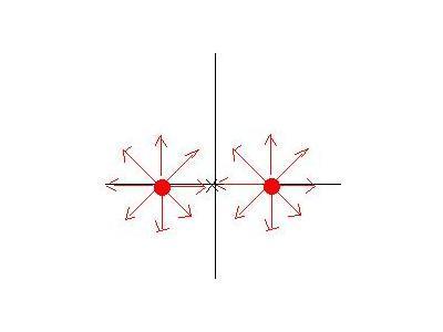

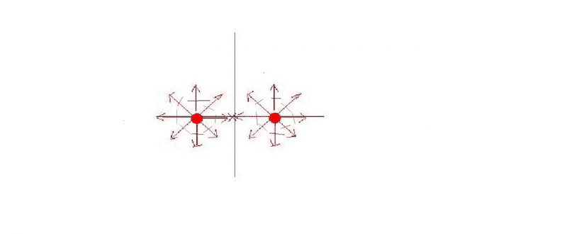

Imagine the charge distributed evenly along the wire. Along the black line between the two charges, the resultant field is perpendicular to the wire as the parallel components cancel.
This is about infinite line,right?
The lines which cancel each other are represented canceling each other in same color.
right?

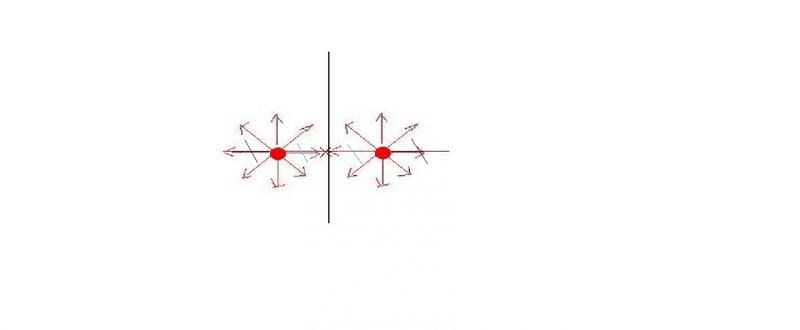

I KNOW it is silly question but Why the following is not correct?

following is the situation in case of mid point
http://www.physics.sjsu.edu/becker/physics51/images/22_18EofLINE.JPG
But we want electric field to be equal at every points not just (in the line of)mid point and that too should be perpendicular to curved surface of cylinder (for ease in calculation )but there is a problem i.e

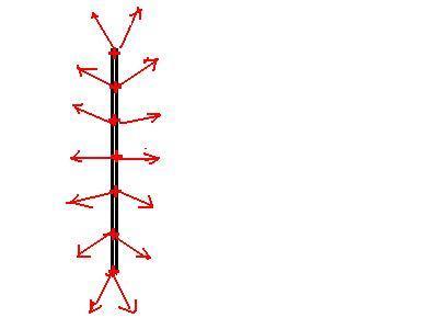

And as a result there would be some amount of electric field at any point on the curved surface in downward direction dEy along with perpendicular Electric fields lines dEx
And then net electric field will not remain perpendicular to the curved surface,because resultant of dEx And dEy simply can not be in direction of dEx .But when we take /assume length/axis /height of cylinder to be infinite
so we can get symmetry .every dEy component (due to upper portion )would get canceled by the dEy component (due to bottom portion)as cylinder of infinite length does not have any length limits.Hence,we get net electric field perpendicular to curved surface.
Right?
