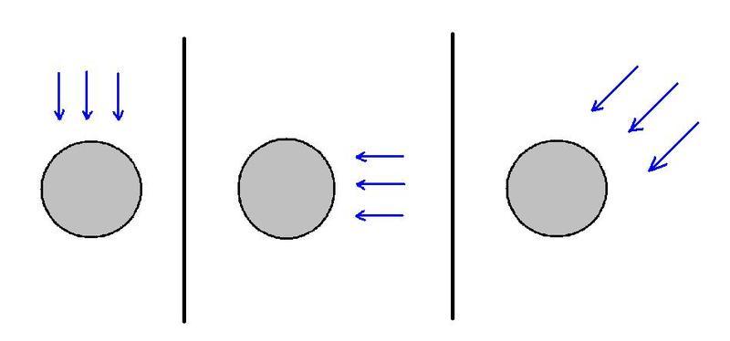

Let's look at a simpler case: a sphere of radius R. Consider the drag force:
1 - when the wind blows at speed v directly to the sphere:
[tex]F_1=\frac{1}{2}\pi R^2\rho Cd_1v^2[/tex]
2- when the wind blows at speed [tex]v\sqrt{2}[/tex] (this looks like the combination of 2 flows of speed v; see the figure):
[tex]F_2=\pi R^2\rho Cd_2v^2[/tex]
If [tex]F_2=F_1\sqrt{2}[/tex] (i.e. your "vector sum" rule is valid) then [tex]Cd_2=Cd_1/\sqrt{2}[/tex] (*). As you know, the drag coefficient is a function of the Reynolds number [tex]Re=\rho Lv/\eta[/tex], and this may lead to (*). However, the function remains unknown. According to Wikipedia, at certain range of the values of speed, dimension, viscosity, etc, Cd may be treated as a constant depending only on the shape, which violates with (*). Have a look at this: http://en.wikipedia.org/wiki/Drag_coefficient

Thanks Hikaru!
Interesting. But, working in another direction, let's assume that for a given velocity, Cd is constant for a sphere since that is a fully symmetrical shape (which as we can see is empirically calculated to have a drag co-efficient of 0.47). It's interesting to note that the drag co-efficient quoted is only accurate to 2 significant digits, as far as we can tell. One could therefore assume that there is a, say, 2%-4% relative error built into the wikipedia values and those quoted for cars, even if the value for a Sphere can be calculated using Stokes' Law. This may mean that the quoted Cd is valid for a variety of speeds as long as the correct errors are propagated.
But anyway, if a wind blows at a velocity of v at a 45° along a Cartesian plane bisecting the sphere at its equator, then the force in that direction is indeed given by:
[tex]F_{45^\circ}=\frac{1}{2}\pi R^2 \rho C_d \nu^2[/tex]
Now I believe, but since I it's been so long since I studied for a BSc in Physics, I could be quite wrong, that it is the force vector that can be safely split along the Cartesian plane. Thus, along the x and y axes:
[tex]F_{x} = \frac{\sqrt{2}}{2}F_{45^\circ} = \frac{\sqrt{2}}{4}\pi R^2 \rho C_d \nu^2[/tex]
[tex]F_{y} = \frac{\sqrt{2}}{2}F_{45^\circ} = \frac{\sqrt{2}}{4}\pi R^2 \rho C_d \nu^2[/tex]

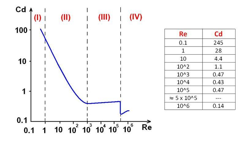

Stokes' Law? The law is valid only for small speeds, so I don't think it can be used to calculate Cd in a wide range.
The only fluid-mechanics-focused book I have also provides experimental analysis on drag on a sphere. They measured Cd versus Re of a sphere, where [tex]Re=\frac{2R\rho v}{\eta}[/tex] and what they got is a graph (see figure attached).
Their analysis points out that the variation can be divided into 4 main ranges, corresponding to 4 regions in the graph:
_ Region (I): [tex]Cd=\frac{24}{Re}[/tex] which is valid for Re<1.
_ Region (II): [tex]Cd=A(1+\frac{a}{\sqrt{Re}})^2[/tex] where a = 9.06 and Aa2 = 24.
_ Region (III): For 103 < Re < (5 x 105), Cd is almost unchanged and is about 0.43-0.47 (just as Wiki says!)
_Region (IV): There is a sudden change at the critical value of Re, and after that, Cd remains unchanged.
Since we mainly focus on the range where Cd=const, I'll consider region (III) only. In this region, 103 < Re < (5 x 105). At room temperature, air viscosity is about [tex]\eta = 1.8 \times 10^{-5} Pas[/tex] and density of air is about [tex]\rho = 1.2kg/m^3[/tex]. Consider a super big ball of R=1m, which might be compared to dimensions of a car. For 103 < Re < (5 x 105), we have v is in the range from 0.0075 m/s to 3.75 m/s. I'm quite surprised at this result. However, this convinces me that if we go out of this range, to a greater speed like 20m/s, we still get Cd=const (as in region (IV)).
