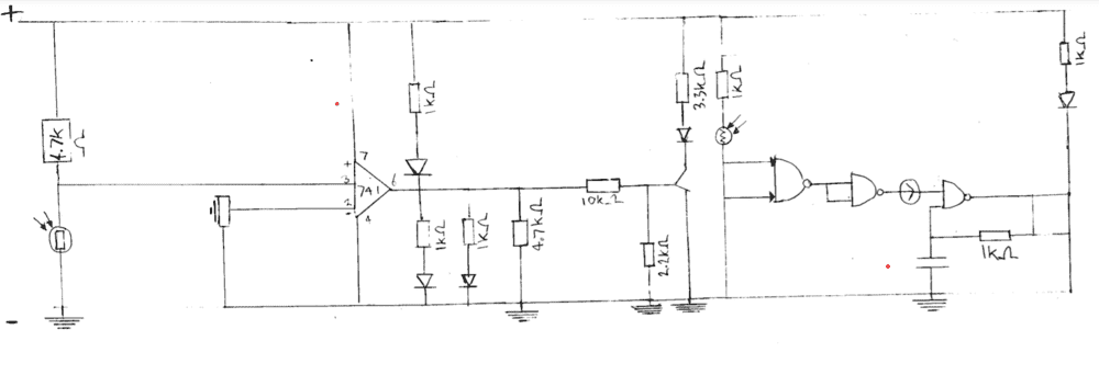

Here is the circuit i have built on a breadboard (link) - Breadboard circuit
i am now trying to draw the circuit for this but struggling
Hi, I have built this circuit on a breadboard and have tried to draw it out but I am pretty sure its not right, needs to include- 741 amplifier,transisitor, NAND gate, 555 timer or NAND gate (for the orange LED)
this is my attempt, can somebody help as I am new to this

What in the world is that supposed to be?
Well, usually one designs a circuit schematically and then implements it on a breadboard to see if it works not vis-versa as you have done. Does your circuit do what you intended? We need to know the function and then we can decide if it is a reasonable circuit. Of course, it is possible we might be able to determine if it will do nothing or even self destruct.

I think it looks reasonably clear. I think you have a LDR which will turn on a opto-coupler and light an LED.
Unless I am seeing a line in the schematic that isn't there, the LED will always be lit.

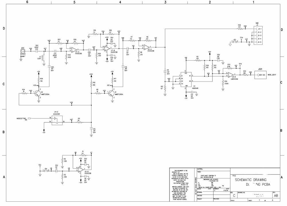

If you are asking how a schematic should look, here is an example from the real world. Yours may not need to be as sophisticated (drawing format, notes, etc.) but the clear communication of what's in the circuit and how they are connected is important.

Where the lines cross to the right of the 741 there should be a dot indicating it is a connection.

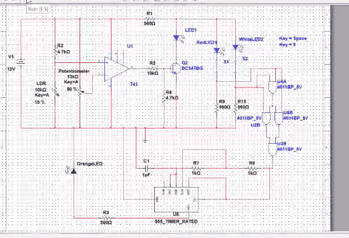

the circuit is intended to match this
controller is required to monitor the natural illumination of a sports stadium and, when the ambient light is below a pre-set level, to switch on external lighting. The system is required to be of high integrity, and various monitoring indicators are to be incorporated as specified below.
Furthermore, the status of the light (Large white LED) is to be monitored, and if this should fail, when the lighting should in fact be on, a warning signal is to be given in the form of a flashing orange LED.
Circuit Requirements
1. A light dependent resistor (LDR) is to be used to determine ambient light levels.
2. A red light emitting diode (LED) should illuminate whenever the ambient light level is below the pre-set value.
3. A green LED should be illuminated if the ambient light is above the predetermined level. Note, the use of two LEDs in this manner serves to indicate that power is applied to the system, as one LED will always be on.
4. An orange LED is to flash on and off repeatedly, in the case that the ambient light level is low, and the white LED is not illuminated, i.e., it has failed.
5. Individual functional blocks of the circuit should be constructed and operation verified on breadboard. One example of such a component block may be the LDR and comparator light detection circuit
