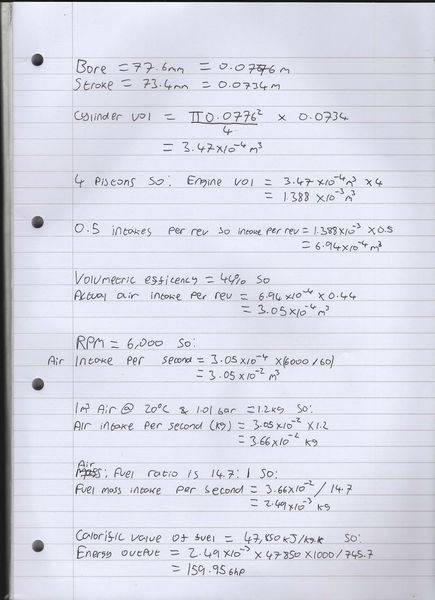

I seem to have had a clarifying moment, I was taking the air:fuel ratio for volume, not mass.
I did ((pi*bore2)/4)*stroke to get the swept volume of each cylinder. I then multiplied that by 4 to get the total swept volume of the engine and divided it by 2 because the pistons only intake air on every other engine revolution. I then multiplied this by the engine's volumetric efficiency to get the actual air intake per revolution. I then multiplied this by the revs per minute and divided it by 60 to get the air intake per second. I looked online and found a mass/m3 value of 1.2kg/m3 for air at 1.01bar and 20C. I multiplied the air intake per second by 1.2 to get the mass of air per second, then divided it by 14.7 to get the intake of fuel in kg/second. I multiplied this by the calorific value of the fuel and multiplied it by 1000 to get the power output of the car in watts and converted that to bhp by dividing it by 745.7 to give me a power output of approx 160bhp.
I'm a little worried that I didn't use the value of 55% pressure drop at the inlet and and didn't account for the value for what I assume is temperature in the calorific value of the fuel.

Those are my (very) rough notes on the engine power output so far. Apologies for the handwriting, combination of dyslexia and recovering collarbone.
As I said previously, the calorific value of the fuel is in kJ/kg.K and I haven't accounted for the K on the end of that and I haven't accounted for the "pressure drop at the inlet of 55% of atmospheric pressure". Which both worry me. Can anyone see where I'd factor those in without getting a number for horsepower that's in the thousands.

Your image didn't upload correctly. :frown:
As I said in my previous post, the problem statement seems to be using incorrect units for the calorific value of the fuel. The correct units should be kJ / kg (No K).

Okay if I account for the pressure drop and use it to alter the mass of the air as it enters the engine, then follow on with those numbers I get 71.98 horsepower.
Checking online I can see that the maximum output of one the 1.4 litre Vauxhall Corsa 5 speed manuals are in the range 85-100. I'll query with my lecturer on the units for calorific value, maybe he's gotten confused with specific heat capacity there.
Do you think 71.98bhp seems a reasonable answer to this?

It seems like a reasonable figure.
