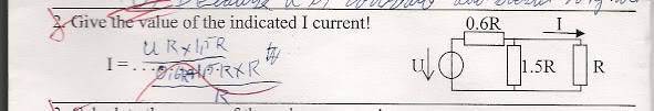

Can somebody please explain to me what i did wrong here? Got exam tomorrow and it would probably be usefull to know.. Thx
axb = a*b/(a+b)
First i tried finding the voltage over 1.5R x R.. Then divide that voltage over R to find the current over R... For some strange reason this is wrong. Plz someone help me to understand why..
treat the 1.5R and R as parallel. then in series with the 0.6R to get the overall resistance. current going through 0.6R = voltage/overall R. Then the same current split into the 1.5R and R, calculate.
nice, thanks a lot. Now i got further :)
However if u would be able to point out what i assumed wrong in my first attempt itd be apreciated as well, so i don't happen to do a similar mistake again
hmm... its like really basic. just get familar with kirchhoffs v and i law. u'll be fine
