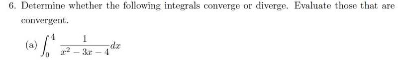

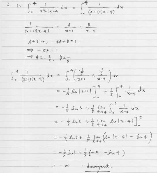

3The attempt at a solution
Is this correct?
Sure, it looks fine to me.

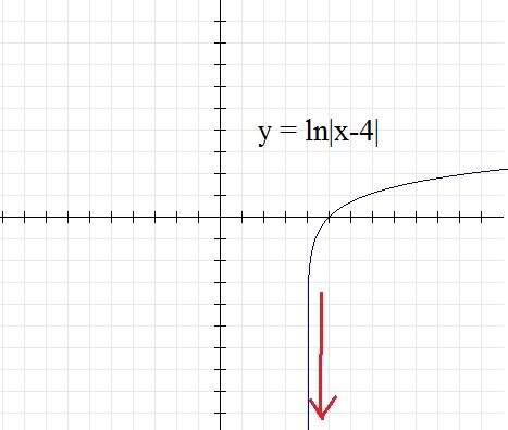

This is what I was confused about.
In the graph above, you can approach 4 from the right but not from the left.
It's an absolute value, temaire. |x-4|. Doesn't that mean anything to you? :)
Oh, so this is the graph. (x is from 3 to 5)
I understand now.
You've got it.
