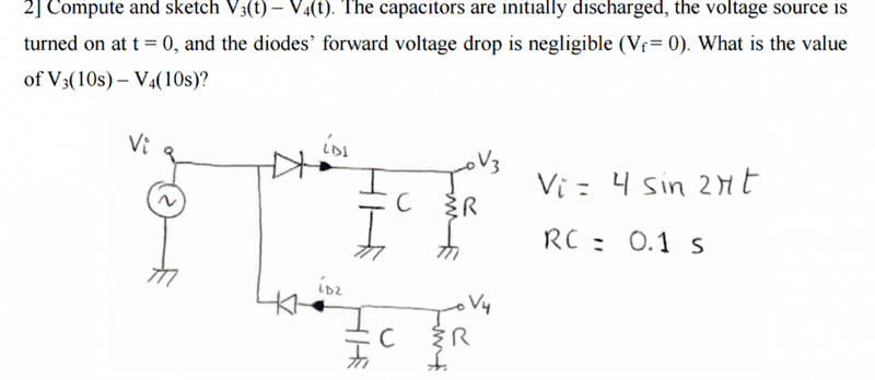

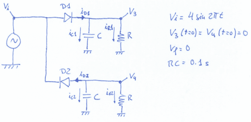

My problem lies in when I get equations like:
and if I plug in Vi and its derivative, I get equations like:
How do I solve for t in these equations if I have a sine and a cosine term that contain t?

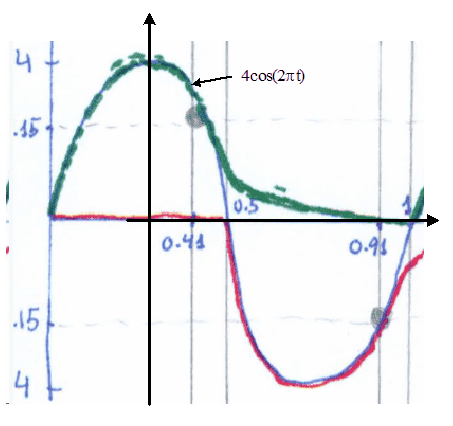

Just set a new start time so that the function becomes a cosine. Now the curve starts out headed towards the point of interest rather than climbing the "backside" of the sine function towards its peak.

Also if I shift like you suggested, I get -0.1 2 pi sin (2 pi t) + cos ( 2 pi t) = 0 which gives me
tan (2 pi t ) = 1/ (0.1 2 pi) which doesn't get the solution I need. Am I doing something wrong?
Also, why would we subtract is by .5? Technically the cosine curve begins .25 seconds in compared to the original sine curve so wouldn't we add .25 to get the true time?
EDIT: Did he get 0.5u - 0.8928 from the original equation where t would equal -0.8928 and he assumes it's periodic every .5 seconds? How does he assume this?

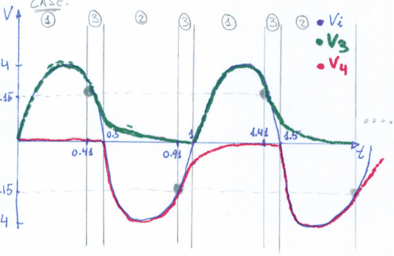

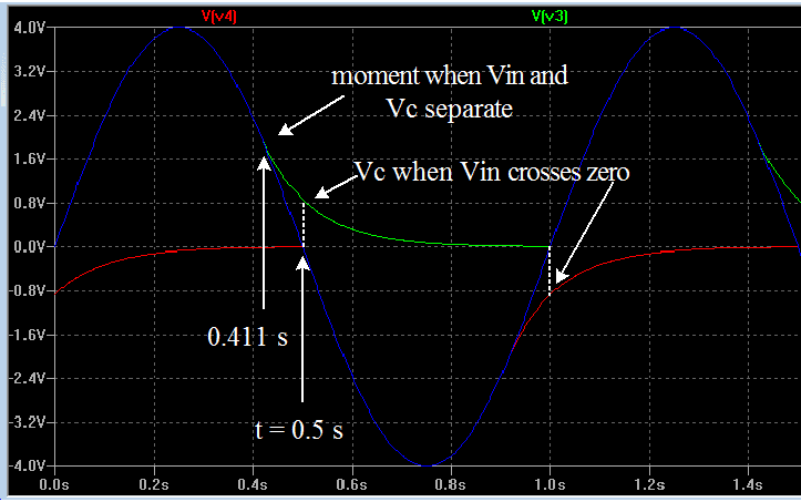

Here's a plot of the voltage waveforms from a simulation of the circuit.
I've annotated the screen capture to show some of the items of interest. The outputs of the two rectifying circuits are symmetrical (red vs green plots), just inverted and time shifted by a half cycle (0.5 seconds).
You're looking to calculate the output voltage (voltage on a capacitor) when the input signal crosses zero. That first happens at t = 0.5 s on the plot, but it's Δt = 0.5 - 0.411 = 0.089 seconds from when the diode turned off and the RC circuit became isolated. That's how long the voltage on the capacitor has had to decay to that point.
If you use a cosine function to find the separation instant, then the cosine's start time would begin when the sine is at its peak at 1/4 second. So a solution using the cosine would yield a time of 0.411 s - 0.25 s = 0.161 s.
So let's say you solved the simultaneous equations using the cosine function and you found the time when the diode stopped conducting to be tx = 0.161 s. Then you can add 1/4 seconds to that to find the "actual" time for the sine function, t = tx + 0.25 = 0.411 s. You can go on from there to find the capacitor voltage at that instant and then how much it decays by time t = 0.5 s.

Thank you so much for the graph. I understand what happens when we shift the graph using cosine instead and I get that answer as well (.411 s).
In regards to if I used the original equations, I first obtain -0.089 seconds. Am I correct to assume that the regular cosine and sine curves periodically intercept each other at half a period, so if I get 0.089, the curves will intercept again at -0.089 + 0.5, and then once more at -0.089 + 1? At the first time, the first diode will turn off and exponentially decay until it reaches 0 where it will again become Vin. When Vin first intercepts 0 , diode 2 turns on because its conditions are satisfied and stays on until its respective equation is violated at -0.089 +0.5n, where in this case n = 2?
Then when Vin again intercepts 0, the first diode turns back on since it exponentially decayed towards 0, and the cycle continues?
It's not so much that the cosine and sine intercept as that they both have the same period and thanks to the symmetry of the circuit anything that happens in one half cycle occurs in mirror image form in the next half cycle. This is true whether you base the math on the cosine or the sine. I just use the switch of trig function to avoid the negative time result in the math and then having to remember how to shift it :smile:. I find it easier knowing that when the math spits out a value that it's for the intended location on the curves and I don't have to go through all the adding or subtracting fractions of a period to adjust things. In this case the cosine places the first solution at the minimum positive time occurrence. After that I know that the same feature repeats every cycle (every second) for the top circuit, while the mirror image takes place a half cycle displaced for the bottom circuit.
So yes, the diodes will alternate turning off at times dictated by -0.089 + 0.5n. The top diode turns off when n is odd, the bottom one turns off when n is even.
