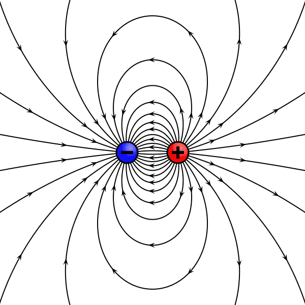

Well if your sine voltage or current source is driving a capacitor, calculating the E-field inside the capacitor as a function of the capacitor voltage is easy, right? Do you know the equation for that?
And if you have a more complicated geometry than just a parallel-plate capacitor, calculating the E-field between the 2 conductors generating the field usually involves integrals, and sometimes you need to use numerical modeling methods to calculate it (like with COMSOL). Are you familiar with those integrals, and maybe with simulation software packages?
https://upload.wikimedia.org/wikipe.../600px-VFPt_dipole_electric_manylines.svg.png
Likes Artyman and dlgoff
