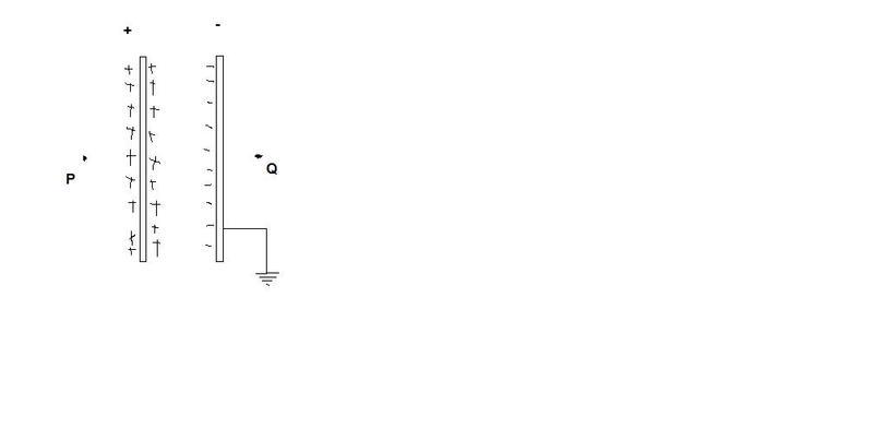

Refer the figure:
At the point P (not far away from the positive plate), there is a net electric field towards left.
There is a net electric field towards right at the point Q.
(btw do we consider the charge on one side of negative plate to find the electric field at Q? Or is it isolated from Q?)

What I mean is that, at the point P, the field from the positive plate pushes to the left, and the negative one pushed to the right, so the fields tend to cancel in this region. In between the plates, the positive plate pushes to the right and the negative one pulls to the right, so the fields reinforce.
If the plates were infinite, the two plates would completely cancel each other outside the region between the plates.
My figure was incorrect. There should not be any positive charges on the left side of the left plate. I understood you now.
