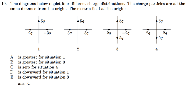

Also, based on this:
I understand why C is correct. But isn't option A and technically C right too?
Since the field vectors would be pointing downward and right with the greatest magnitude in situation 1.
Sorry for the extra questions. They're just related and I rather not open a new thread.

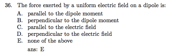

Why is the force exerted by a uniform electric field not parallel to it? The force and electric field vectors are parallel, right? Why does the field have to not be parallel to the dipole moment in order for there to be torque? Why can't it be just perpendicular as well? Dipole moments are a little new and any explanation would be very helpful!
Any help? I am trying to think about it logically but am missing something.
I would tend to agree that A is true too. I'll look more at this... It would help if you could write down the relative total vector fields for each configuration...
The key is the uniformity of the electric field. The net force of a uniform electric field on an electric dipole is what?
There may be a temporary force on the ends of the dipole if it is not yet aligned with the E-field, but eventually what happens?
Hmmm..don't dipoles become aligned to become parallel in the electric field? Therefore there would be no torque, but isn't there still a parallel force from the electric field? You stress the uniformity though...are the field vectors supposed to cancel, regardless of the object in it?
You have the correct intuition. If the dipole is not yet aligned, there is a net torque. If there is no damping, the dipole will oscillate.
Once the dipole is aligned with the E-field, there is no net force or torque. I have a feeling that you can write the equations that show that...
