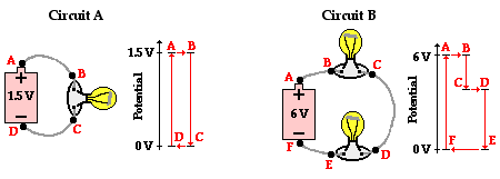

I'm just starting to study circuits, and there's a thing I don't understand about electric potential.
I was under the impression that as a charge moves through the circuit from the high potential end of the battery to the low potential end, it lost electric potential energy which became kinetic energy.
However, I found this graph:
In circuit B, the diagram states that from A to B the electric potential stays at 6V. Surely the charge would lose some electric potential and gain some kinetic energy?
Can anyone explain this?
Thanks!

There is no gain in kinetic energy. You are confusing this with a mass moving in a gravitational field (where when it falls it loses PE and gains KE).
There is very little electrical potential loss in the wire because its resistance is so low. The resistance of the light bulbs is high, so that is where the bulk of the electrical potential (voltage) is dropped.
The current around the loop is constant, so all the charges move at the same speed the whole time they are flowing around the loop.
In circuit analysis, we usually suppose that resistance of a wire is '0', which is usually a good approximation for most electronics circuits, so if I have a certain potential 'A' in a point of a wire, if on the same wire, i don't go through a dipole (electronics component) i 'll have the same potential (which is an approximation, a good approximation), because the resistance of the wire is neglectable

Keep in mind we don't talk too much about potential difference as such in a circuit... what we are more interested in is voltage drop across various elements in a circuit
Take your circuit B, 6V battery and 2 lamps. IF the lamps are identical ie. have the same resistance, then the voltage drop across each of them will be equal measured at 3V...
putting a voltmeter across lamp 1, points B and C you will measure 3V
putting a voltmeter across lamp 2, points D and E you will again measure 3V
the addition of the 2 voltage drops across each lamp will equal the total voltage supplied by the battery = 6V

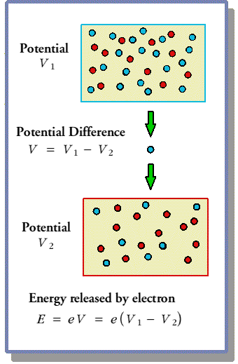

Hello again! Sorry to be a pain, but I'm still having trouble understanding.
I understand now, thanks to your answers, how voltage changes throughout the circuit, but I don't understand why the following sentence is true:
"Two points in an electric circuit that are connected by an ideal conductor without resistance and not within a changing magnetic field, have a voltage of zero."
Take these two situations for example:
and
In the first situation, an electron moving from the upper box to the lower box loses electric potential. Across any two points in its trajectory there will be a certain voltage.
In the second situation, suddenly across two points before the bulb there is no voltage (I'm assuming it's an ideal conductor). How is this possible?
Thanks again.
The voltage between two points is the product of the current times the resistance. The resistance of an ideal conductor is zero, so no matter how much current flows the voltage is zero.
If you have a perfect conductor between the battery and the lamp, then the lamp, then a perfect conductor back to the battery, there will be no voltage difference along either conductor (both ends will be at the same voltage in the circuit), and so the full battery voltage will appear across the lamp. The resistance of the lamp will then be what limits the current.
If you remove the lamp so that you have a perfect conductor across the battery, then for an ideal battery the current becomes infinite. However, even though you can get perfect conductors there is no such thing as a perfect battery and so the current is limited in this case by the internal limitations of the short-circuited battery. Both battery terminals will then be at the same voltage.

But what if I see the voltage as the amount of potential energy the electron loses as it moves towards the positive terminal of the battery? Why does it lose this energy in the first example but not in the second?
