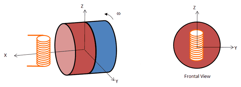

And thank you for your reply! If you let me, I want to ask you other geometry. This is going to help me understand a bit more. I drew it to make it easier to see the problem. The red/blue part of magnet is only north/south pole division (ie, in the picture, it is polarized along axis X).
Diagram of a cylindrical permanent magnet with red and blue halves, rotating about the X axis with angular velocity ω, with a solenoid coil placed along the X axis in front of one end, and a frontal view showing the coil inside the red circular face.
If this magnet rotates around axis X with a constant speed ω, as the coil remain still, should I expect induced voltage? I guess not, because, again, θ = 90°. But what I can't see is: what if the magnet is polarized in Z axis? Notice that this is very similar to case (2) I described before, but the coil is in front of the magnet, not surrounding it.

First part--you are right. Second part--what do you think? Draw your magnet as a dipole, for example, and draw a few field lines around it to see what happens.
I think I see... dB/dt will not be zero.
Thanks for your help, marcusl.
