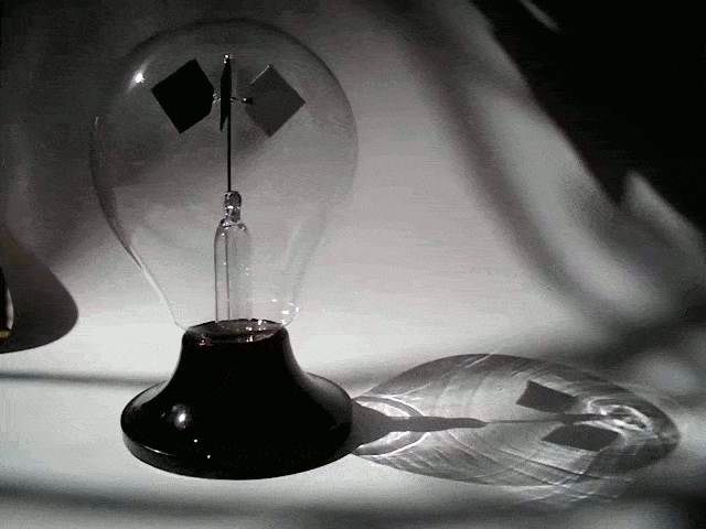

If you have a very light disk, able to rotate around a fixed axis, and make half the disk like a mirror, and black the other half, it will rotate when exposed to light. The photons colliding with the mirror part are reflected, and their momentum change from p to -p, they transfer 2p momentum to that half of the disk. The photons falling to the black part are absorbed, and they give momentum p to the black part. Change of momentum means force acting for some short time, and it provides torque. The disk will rotate.
See also http://en.wikipedia.org/wiki/Crookes_radiometer

If you read the link you provided, you will notice that your explanation is not the correct one. The modern interpretation is that the Crookes radiometer is simply a heat engine.
ETA: But of course, to be relevant to the OP, charges can feel a force from light.
Anyway, light interacts with sheets of the mill, and reflected from the silver part, absorbed by the other. Both reflection and absorption occurs as the electric field of light interacts with the charged particles, force them to vibrate, and producing electric field which radiates back or heats up the black surface. What is the real reason of rotation is an other question.

To expand . . . . The Crooke's Radiometer you can buy works because there is a temperature difference between the black and white sides. The black has absorbed more energy. The vacuum is not very good so there are a significant number of collisions with air molecules. The ones hitting the hot side will leave with more momentum than the ones hitting the cold side. So the vane is pushed the 'wrong' way round (away from the black side) - different from one in a good vacuum, where the momentum change is maximum on the white side, causing it to turn away from the white side. I have never seen a 'proper' radiometer.
