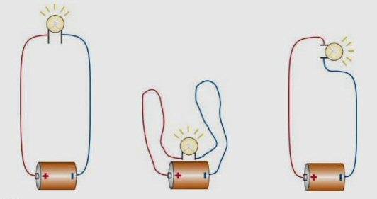

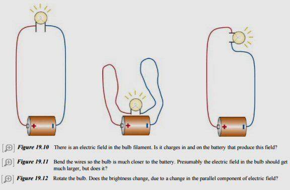

I'm asking how the functioning of these three circuits might be described in a "Senior Model for Dummies" text, both (a) when the battery is first connected, and (b) after a steady state is reached. What happens in and around the battery, the wires, and the bulb that makes it light up?

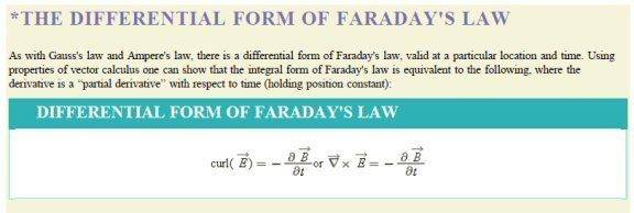

It's true that my model is essentially a qualitative one (since I'm trying to explain a vacuum tube guitar amp to a ten year old). But it's not true that Chabay and Sherwood are light on the math. Their text is chock-full of stuff like this:
But they're smart enough to remember that statements like that are simply thoughts recorded in another language, a language that can be translated, albeit more verbosely, into plain English. And they understand the importance of this translation from a pedagogical standpoint. Nikola Tesla understood the need for this kind of translation even better: "Today's scientists have substituted mathematics for experiments, and they wander off through equation after equation, and eventually build a structure which has no relation to reality." Translations for Dummies are reality checks.

I'm looking for someone who can give me the gist of the Senior Model, using illustrations and words like Chabay and Sherwood, regarding these three circuits:
And why those three? Because they focus on the points where the Senior Model doesn't make sense to me (and apparently others -- the questions that come to mind are right there in the text.) Chabay and Sherwood resolve these difficulties by talking about surface charges instead of "differential waves," essentially setting the Senior Model aside. Yet intelligent and informed people here insist that the Senior Model is a better, more realistic model. It would help if I could compare apples to apples. I've got the circuits; I've got the Surface Charge model and explanation; what I don't have is the Senior Model explanation at a similar level of abstraction. So I ask again: How might the functioning of these three circuits be described, with the Senior Model in mind, both (a) when the battery is first connected, and (b) after a steady state is reached. What happens in and around the battery, the wires, and the bulb that makes it light up?
  • #37
Did you ever think that the reason the other models exist is that they are the simplified abstractions of the 'Senior Model' (it is the whole apple).
It's possible but unnecessary at to field level to completely analyze these three circuits to some mystical level you need to reconcile them all in your head unless you need information about transient effects that are close to zero in human terms at low power levels. Now if you're switching on a main HVDC utility feed instead of a tube amplifier the magnitude of the transient effects on components might warrant a full analysis as the energy levels before steady state are significant. So if you want to understand the 'Senior Model' that many have taken years to build an mental framework about then it's up to you IMO to do the work yourself as I believe in the end your answer will be the only one you accept.

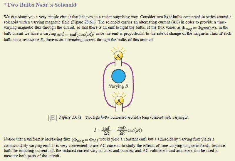

Earlier sophiecentaur asked, "What do you actually want out of this exercise?" Perhaps this will help you folks understand what I'm looking for.

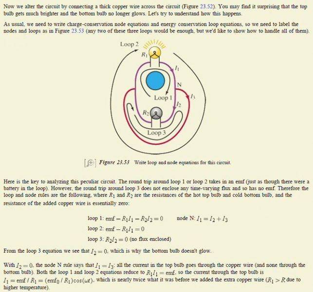

Chabay and Sherwood discuss, under the heading "Some Peculiar Circuits," the following:
They then make a modification:

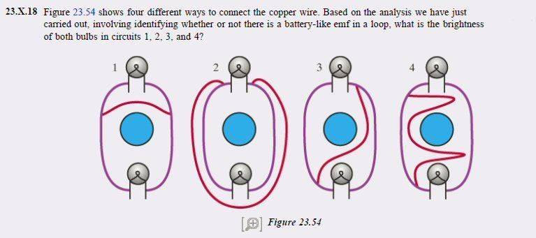

And finally they ask the student to apply what he has learned:
What I'm looking for is a way to analyze circuits like those above qualitatively, so I can get the right answers without doing a lot of math. So I can kind of just "look at the circuit" and "intuitively divine" what will happen. Now the key in this case is the parenthesized comment in the former illustration, obscured by a lot of formulae, that in Loop 3 there is no current because "(no flux enclosed)". With this tidbit in hand, I can look at the above circuits and say, with some degree of confidence, that in (1) only the bottom bulb will light, in (2) they will both light, in (3) only the top bulb will light, and in (4) both bulbs will light. (Boy, I hope I got those right!)
Now all of the current just discussed is obviously induced; the effect on the electrons in the wires is the almost magical result of their interaction with the invisible field emanating from the coil. But I'm pretty sure that if we connected a battery directly to those wires in an appropriate spots, the effects of the solenoid field would be minimal in comparison (unless, of course, the current in the solenoid was unusually strong). Kind of like the way we get hum in a guitar amp if the power transformer is too close to the pre-amp tubes, though the overall operation of the amplifier -- the "through the wires stuff" -- remains essentially the same. So tidbit number two is that a direct connection typically beats an inductive connection, and usually by quite a bit.
Get the idea? I'm looking for (a) a consistent model plus (b) a handful of such "tidbits" that I can pass along to my ten-year-old. And the better I understand the choices, the better I'll be able to pick and choose. So if there are elements of the Senior Model that will help me in this endeavor, please elaborate them. If not, let me know I'm wasting my time and I'll go shopping elsewhere.

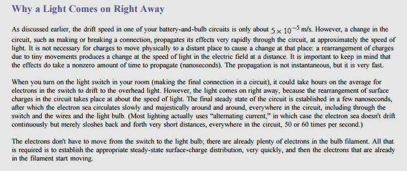

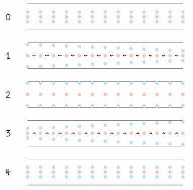

Let's please get back to my question. This is as far as Chabay & Sherwood take me:
Unfortunately, they don't specifically address variations in surface charge in AC circuits and I thus need to extrapolate. And this is what comes to mind:
The "final steady state" of the circuit isn't so "steady." Since the flow of electrons in the wires is reversing itself many times per second, the surface electrons must also re-arranging themselves continuously, at a similar rate. In other words, it appears that the movement of electrons in a wire carrying alternating current involves both constant re-arrangement and flow of electrons, where the blue surface electrons form, not at the speed of light but in the 60-hertz range, a kind of three-dimensional sine wave in the wire, pushing the pink current electrons back and forth. Like so:
At time 0 we have the wire in equilibrium. The sine wave is at 0, start of a cycle.
At time 1 the blue electrons on the left have made it all the way to the surface, while the blue electrons at the other end of the wire have hardly moved at all. This creates a potential difference that sucks the pink electrons leftward. The sine wave has reached it's positive peak.
At time 2 all the blue electrons have reached the surface. There is no potential difference and the pink electrons have thus stopped moving. The sine wave is again at 0, in the middle of the cycle.
At time 3 the blue electrons on the left have fallen inward while the ones on the right are still on the surface. This creates a potential difference that shoves the pink electrons to the right. The sine wave now reaches it's negative peak.
At time 4 all the blue electrons have fallen back to the initial state, and the pink electrons have again ceased to move. The sine wave is again at 0, ready for the next cycle.
Question: Is that a reasonable extrapolation of the Chabay & Sherwood Surface Charge model?
(And yes, nsaspook, I'm "back to electrons in electrical science being the focus" because I thought we agreed that it isn't helpful to apply the Senior Model in cases like this where the wires are anything but parallel.)
  • #47
It is as reasonable as is your reasoning. You can extrapolate C&S any way you want if it makes you happy.
I don't believe a word of it. Your surface charge model denies the presence of the magnetic fields that accompany all electron motion. If electrons suck each other along then it is because they are mobilised by the presence of a magnetic field outside the wire.
  • #48
First of all, it's not my surface charge model. Chabay & Sherwood were inspired by the work of Herman Haertel (his seminal paper can be found here: http://files.eric.ed.gov/fulltext/ED287730.pdf ) and they further developed his ideas into a complete course and textbook for college-level physics students (their reasonings can be found here: http://www.matterandinteractions.org/Content/Articles/circuit.pdf ).
Secondly, nowhere do they deny the existence or the efficacy of either electric or magnetic fields; on the contrary, their text is chock-full of them (and the vectors and formulae that go with them). They do, however, take the position that electromagnetic fields are caused by certain arrangements and movements of electrons, and thus tend to view the subject matter from that perspective. Their pedagogical reasons for eliminating "field lines" from their text can be found in Section IX of their paper here ( http://www.matterandinteractions.org/Content/Articles/AJP-EandM.pdf ).
That electric and magnetic fields are caused by certain arrangements and movements of electrons seems perfectly reasonable to me: scramble the electrons in a magnetized piece of ferrous metal and we find the magnetic field disappears; stop the movement of electrons in a wire and we find the same thing; pair up each and every electron with a proton and the electric field is neutralized.
What makes the subject difficult, of course, is that the very electrons that cause the fields are also affected by the fields. But electrons seem more real (since they can be easily pictured as part of the "matter" category) and are thus easier to describe to a ten-year-old. Electrons in certain arrangements and motions cause fields; but fields -- though they can cause certain arrangements and motions in electrons -- don't cause electrons themselves to exist. J. T. Bell puts it like this:
"Electric fields, magnetic fields, energy, and many other things, are all concepts that we use to explain the observed relationships involving physical objects and their motions. But 'energy' is not a substance in and of itself; it exists only in the context of two or more objects. We cannot observe energy in isolation, or measure it directly. We can only infer the amount of energy involved in any process by measuring the positions and locations of objects before, during, and/or after that process, and performing some calculations. Similarly for electric and magnetic fields. After all, we define the presence of electric and magnetic fields by the observation that certain objects placed in proximity to each other move in ways that cannot be explained by simple contact-type pushes or pulls. I'm not trying to denigrate or belittle these concepts, or suggest that there's any useful replacement for them. They're amazingly useful, and I would not want to try to do physics without them. But we need to keep in mind the dangers of excessive reification of the concepts that we invent to explain what we actually observe. That is, we need to be careful not to ascribe 'too much reality' to them."
