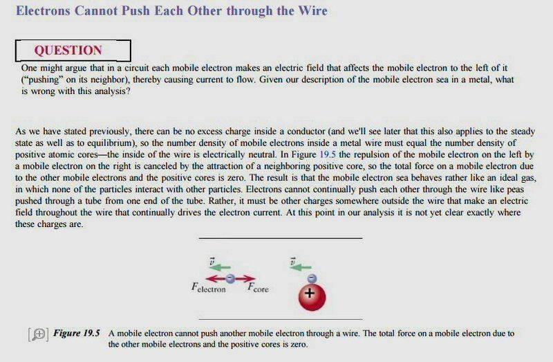

I've been doing some bedtime reading in Chabay & Sherwood's Matter & Interactions textbook (https://www.amazon.com/gp/product/0470503475/?tag=pfamazon01-20) and have come across some interesting tidbits. Here they are:
I've always pictured electrons pushing each other through a wire, kind of like peas through a drinking straw. I thought this was a good way of explaining how, for example, a ceiling light comes on immediately even though the drift speed of electrons is relatively slow. Turns out Chabay and Sherwood say it isn't so:
Textbook figure 19.5 showing two mobile electrons with arrows labelled v and F_electron and F_core; one electron sits between two positive cores, the other beside a single positive core, illustrating zero net force on the electron.

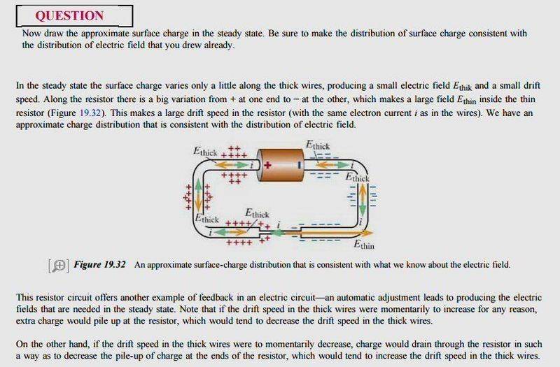

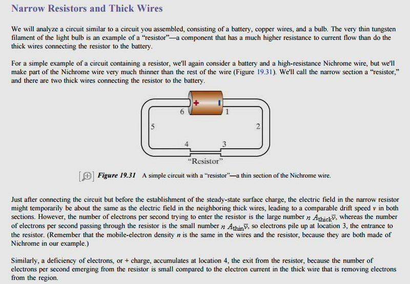

And so I think, okay, let's assume they're right. So what does the pushing? Chabay and Sherwood say it's electric fields that push the electrons through the wires, and that these fields are caused by particular, non-uniform arrangements of electrons on the surface of the wires -- electrons distinct from the "current carrying electrons" deeper inside:
Textbook page titled Narrow Resistors and Thick Wires, with a diagram of a rectangular circuit: a battery with plus and minus terminals, thick wires, and a thin section labeled Resistor at the bottom, numbered points 1 through 6 around the loop.
They even ask the student to draw a map showing the arrangement of surface charges in a simple circuit:

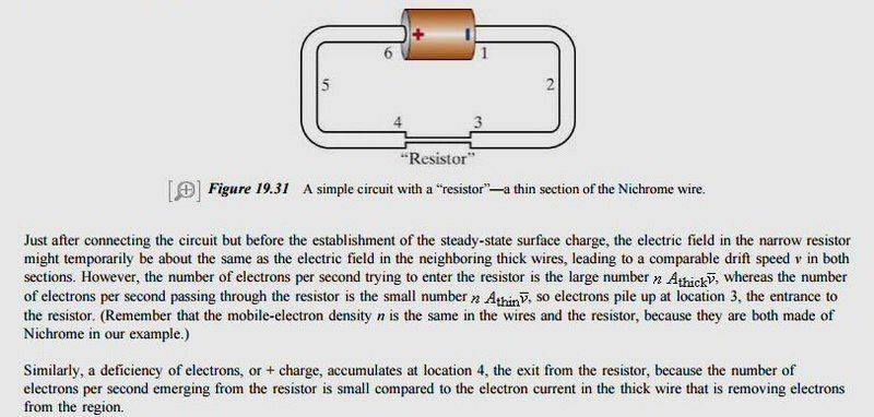

Figure 19.32: schematic of a closed loop circuit with a thick-wire battery at top and a thin resistor at bottom, showing + and - surface charges and arrows for E thick and E thin fields.
And I think, Okay, that sounds reasonable. (Bear in mind that there's a lot of math between these excerpts where they make their case in a more quantitative fashion.)

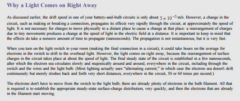

Then they explain why our ceiling light behaves as it does:
Screenshot of a textbook page titled "Why a Light Comes on Right Away" with three paragraphs of body text discussing electron drift speed and surface charge in circuits.

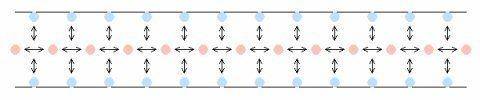

And that's where, I think, they fumble the ball a little. Why? Because they say, "the rearrangement of the surface charges in the circuit takes place at about the speed of light," and that "the final steady state of the circuit is established in a few nanoseconds," just before they say, "Most lighting actually uses 'alternating current,' in which case the electron sea doesn't drift continuously but merely sloshes back and forth very short distances, everywhere in the circuit, 50 or 60 times per second." Which makes me think that the "final steady state" of my ceiling-light circuit isn't so steady. The surface charges on the wires must be re-arranging themselves continuously, 50 or 60 times a second.
In other words, it appears that the movement of electrons in a wire carrying alternative current involves both constant "re-arrangement" and "flow" like so...

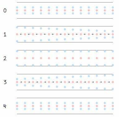

Diagram of a horizontal wire with alternating blue dots above and below and pink dots along the centre, with small arrows between them showing charge arrangement along the wire.
...where the blue dots represent the "surface electrons" that move toward and away from the surface of the wire, and the pink dots represent "current electrons" that move, longitudinally, through the wire.
Now it seems to me we can picture the various arrangements of the blue "surface electrons" in such a circuit as a forming, over time, a kind of three-dimensional sine wave in the wire, pushing the pink "current electrons" back and forth. Like so:
Five horizontal rows of red and blue dots between lines, numbered 0 to 4, showing a lattice of charges; rows 1 and 3 have arrows pointing left and right respectively, with the arrows lined along the row.
At time 0 we have the wire in equilibrium. The sine wave is at 0, start of a cycle.
At time 1 the blue electrons on the left have made it all the way to the surface, while the blue electrons at the other end of the wire have hardly moved at all. This creates a potential difference that sucks the pink electrons leftward. The sine wave has reached it's positive peak.
At time 2 all the blue electrons have reached the surface. There is no potential difference and the pink electrons have thus stopped moving. The sine wave is again at 0, in the middle of the cycle.
At time 3 the blue electrons on the left have fallen inward while the ones on the right are still on the surface. This creates a potential difference that pushes the pink electrons to the right. The sine wave now reaches it's negative peak.
At time 4 all the blue electrons have fallen back to the initial state, and the pink electrons have again ceased to move. The sine wave is again at 0, end of cycle.

You have now discovered the truth. It has clearly come as a bit of a shock.
You now know that an EM wave follows the wire surface.
That the electron disturbance travels on the surface of the conductor at close to the speed of light.
The conductive wires guide the E and M fields that carry energy from the supply to the load.
The direction of the energy transfer is the Poynting vector.
The electric and magnetic fields between the wires carry the energy, not the wire.

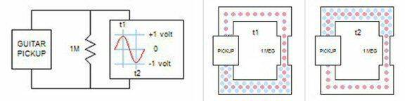

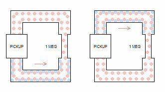

Two-panel schematic: left shows a guitar pickup connected through a 1M resistor to a box with a sine-wave plot labelled +1 volt, 0, -1 volt, with t1 and t2 marked; right shows two boxes with pink and blue charge dots on the surrounding wires, labelled t1 and t2, with PICKUP and 1MEG.
Turns out that intuitive guess wasn't far off, at least according to Chabay and Sherwood (though the ratio of surface-to-current electrons is a bit exaggerated in the images -- seems it doesn't take many surface charge electrons to move a lot of current electrons). At t1 there really is an excess of electrons on the (surface of) the bottom leg of the circuit, and a corresponding deficit of electrons on the (surface of) the top leg. And at t2 there really is a dearth of electrons on the (surface of) the bottom leg, with a corresponding surplus on the top leg. We thus have a picture that agrees with the words that agrees with the formulas; intuition and reality have kissed.

I think your OP misses some key points that are explained in the skin effects article linked above.
The "pink" electrons in the center hardly move at all. It is the electrons at the skin that carry the power current. The approximate electrical model of a solid wire with AC is that of a hollow cylinder.
Circular cross-section of a conductor shaded red at the outer edge and white toward the center, with a dashed circle marking the skin depth delta near the surface.
Distribution of current flow in a cylindrical conductor, shown in cross section. For alternating current, most (63%) of the electric current flows between the surface and the skin depth, δ, which depends on the frequency of the current and the electrical and magnetic properties of the conductor.​

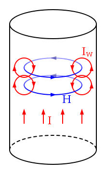

Your analysis based on charge density is seriously deficient because it does not consider the dominant effect, namely eddy current loops.
Diagram of a cylindrical conductor carrying alternating current: upward current arrows (I) in the core, circular blue H-field loops around the axis, and red eddy current loops near the surface, with I_W labeled.
Skin depth is due to the circulating eddy currents(arising from a changing H field) cancelling the current flow in the center of a conductor and reinforcing it in the skin.​

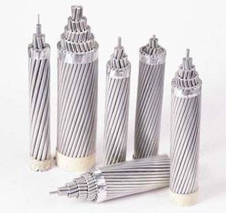

Skin effect is why power line conductors (and common lamp cords and even cheap USB cables ) are multi-strand. For one thing, a multi-strand bundle has a higher ratio of surface area/mass than does a solid wire. For another, each conducting strand in the bundle carries current, even the ones that pass through the center of the bundle. Some power line conductors have a center core that is selected for tensile strength, not electrical conductivity. The spiral twisting of the strands also aids the electrical properties although I don't remember how. Busbars designed for extremely high currents are actually built as hollow cylinders.
Photo of six bare stranded aluminium overhead power line conductors standing upright on a white background, with a steel core visible at the top of each cable.
The same reasoning applied when there are multiple conductors per phase in high voltage power transmission lines, 2, 3, and even 4 multi-strand bundles are strung. They are always arranged as if on the perimeter of an imaginary circle. None are routed through the center of the circle. That is illustrated by the spacer below which can arrange 6 conductors in a single phase of a three phase line. The bottom picture shows four conductors per phase. The multiple conductors approximate the electrical characteristics of a large-diameter hollow cylinder which gives less losses than the same mass of strands all wound on a single bundle with a smaller diameter and much better than the same mass as a solid wire.

All this arrangement of strands, bundles, and conductors is designed to minimze the resistive losses of the power line.
Edit: I neglected to say that each strand in a multi-strand bundle has its own skin effect, and that small-diameter eddy-current-loops have less losses than large-diameter loops. The extremely fine strands in a lamp cord bundle have relatively little eddy current losses.

I do acknowledge them. In fact, I'm picturing the blue dots in this diagram...
Two diagrams of a rectangular loop conductor with pink dots filling its thickness, a box labelled PICKUP on the left and the label 1 MEG inside the loop, with a red arrow pointing right along the inner edge.
...moving like the blue arrows in this diagram:
Diagram of a cylindrical wire with red upward arrows along the lower part and blue curved loops drawn inside the upper part, showing circulating eddy currents.
It's just hard to show at the smaller scale. It seems to me that the smaller eddy currents are undesirable and that in the ideal (but, I imagine, impossible-to-achieve) case the blue guys would simply move toward and away from the surface of the wire, as required, and may also follow the path of the larger blue loops (which seems harmless enough, and may even prove beneficial). But in this ideal case they would avoid the smaller blue loops which actually oppose the pink flow of current about half the time.

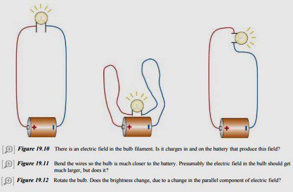

Diagram of a closed circuit with a battery on the left and a globe lamp on the right, with a red top wire and blue bottom wire, showing field lines and red plus and blue minus surface charges.
...then why doesn't a significant change in physical configuration make the bulb more or less bright? Or, as I originally asked, why doesn't the physical configuration of the heater wires in a tube amp, like those variants shown below, have a greater effect on performance?

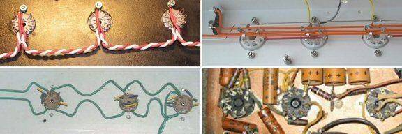

Four photographs of heater wiring layouts in vacuum tube amplifiers, showing twisted and looped wires connected to ceramic tube sockets mounted on a chassis.
(The bottom right layout uses the chassis as one of the wires.) Thanks to Chabay and Sherwood, the answer is now clear: the surface electrons arrange themselves differently in each case to automatically compensate, as best they can, for variations in the layout. In short, the surface electrons automatically arrange themselves so that the resulting fields will normalize the flow of current electrons in the circuit.
Where the conductors fold back to lessen the distance, the electric field remains the same voltage while the magnetic field of the overlap mostly cancels. That shortens the circuit electromagnetically, in the same way as using shorter wires. It is often forgotten that the voltage drop along the wires is much less than the drop across the load.

I'm having trouble reconciling your description with this one from Chabay and Sherwood:
Schematic of a simple circuit with a battery at top and a narrow resistor labelled "Resistor" on the bottom wire, with numbered locations 1 to 6 marking points around the loop.
1. Your description sounds like the chemically-induced movement of electrons from the positive to the negative end of the battery causes symmetrical fields to emanate simultaneously from both ends of the battery, causing the steady-state surplus of surface charge at location 3, and the steady-state deficit of surface charge at location 4, to form simultaneously -- entirely due to the efficacy of the fields. Bear with me.
2. Their description, on the other hand, has electrons leaving the negative end of the battery and piling up at the entrance to the resistor (because they can't easily get through), and this, in turn, causes a deficit of electrons at the resistor's exit, etc. The steady-state surplus of surface charge at location 3 thus forms first, and the steady-state deficit of surface charge at location 4 thus forms later -- both due to a clockwise flow of electrons through the circuit. Keep bearing.
3. I would intuitively posit that electrons are sucked into the battery from all along the left wire (leaving a deficit at location 4) and are simultaneously shoved into the right wire (causing a surplus at location 3). Which obviously sounds more like the simultaneous effects of the fields/transients/waves that you describe than the clockwise, step-by-step description given by Chabay and Sherwood.

Sorry, guys, but I need an example. Let's take these three circuits:
Three battery and light bulb circuits: left, a closed loop with a red wire and a blue wire running from the battery to the bulb at the top; middle, the wires twisted and looped around the bulb at the bottom; right, the bulb at the top with the wires running down to the battery at the bottom.
The junior model says that in all three, a chemical reaction in the battery causes electrons to be simultaneously sucked from the red wire (into the battery) and shoved into the blue wire (from the battery). This causes a deficit of surface electrons in the red wire, and a corresponding surplus of surface electrons in the blue wire -- and this difference in surface charge accounts for the potential difference, or voltage, that we observe (with our voltmeter) between the wires and across the bulb. The uniform flow of other electrons through the entire circuit (that we can measure with an ammeter) is called current. The bulb glows because current electrons, flowing through the highly-resistant filament of the bulb, collide with obstructions, heat up the filament, and release energy in the form of photons.
How would you describe the operation of these circuits with the senior model in mind? Be sure to include an explanation of how and why the "differential wave" manages to impart virtually the same amount of energy to the load whether the wires are parallel, goofed up, or the bulb is turned 90 degrees from it's former orientation.
I see no reason why the understanding must be made more difficult by scrambling the 3D field geometry. The Senior Physics Model needs the understanding of a Physicist, so let's start at the beginning.
