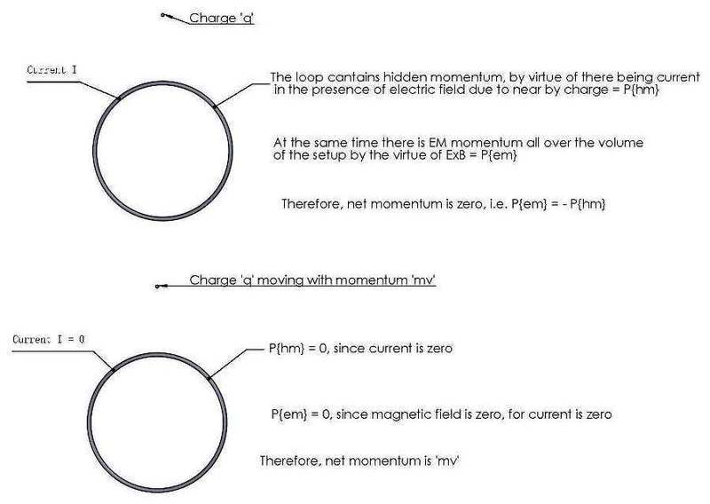

May be someone can repair this 'nonsense' too, the upper setup is with loop carrying current and a stationary charge w.r.t loop, in the lower setup the current dies down and according to Maxwell, the charge starts to move, without any back reaction force.
https://www.physicsforums.com/attachment.php?attachmentid=68924&stc=1&d=1398184742​
So, what is the solution to this 'apparent' violation of conservation of momentum.

Here it is again, the upper part of the image is the static situation with current, the lower part represents the situation after the current dies down. The question is clear, why are we ending up with net momentum, when current dies down, if we started with net zero momentum and there is No external force involved ? This is a serious problem with classical electrodynamics represented by Maxwell's equations.

Could you point me to a clear statement of the problem? The only thing wrong I can make out in the figures is the assignment of the momentum in non-relativistic (Newtonian) terms. If it comes to "hidden momentum" it is very important to use relativistic expressions everywhere.
Further, it's clear that in both situations there are forces acting on the loop and the byflying charge. It's not a priori clear to me, whether you really can neglect the radiation reaction on the whole sysetm. Then it becomes a pretty complicated problem.

Yes, we can neglect the radiation.
Further, seems like you are missing the point, first, ofcourse the hidden momentum in the figure is relativistic in nature, but still it comes under the domain of classical electrodynamics. And yes, we can use relativistic expressions everywhere, but that's not going to change anything.
And here is the overview of the problem again,
There is a current carrying loop and a charge at rest w.r.t each other, now, according to Griffiths, there is an EM momentum(ExB) density around the setup and a relativistic mechanical momentum residing in the current carrying loop. And this make the whole setup stationary and the situation does not violate center of Energy theorem. Do you agree till now?
If yes, then respecting the conservation of momentum, we should also have zero momentum when the current in the loop dies down, but Maxwell's equations predict that only the charge will experience the force ([itex]\textbf{F} = q\textbf{E} = -q\frac{∂\textbf{A}}{∂t}[/itex]), whereas, we don't have anything in Maxwell's Equations that says there will be an equal and opposite force on the loop.
Therefore, we end up with net momentum, in the form of moving charge, which violates conservation of momentum.
I hope this is a clear representation of the problem, I was referring to.
Thanks.

Nope, there is no violation of momentum. Admittedly it is much simpler to neglect radiation here.
When the current dies there is no hidden momentum or anything relativistic, but anyway...
It is quite easy to see that there is going to be an opposite momentum in the electromagnetic field within the loop(let's consider it a thin solenoid to be more specific).
Think about the electric field due to the charge inside the solenoid where previously was the magnetic field when there was current. To this field it corresponds a momentum density within the solenoid that can be integrated to a momentum that is equal and opposite to the linear momentum of the charge.
Basically where we had net momentum zero with the EM and the hidden momentum, now we just substitute hidden momentum by momentum of the charge, the EM momentum is the same.
How can there be EM momentum when there is NO current and therefore NO magnetic field, i.e. [itex]\textbf{E}\times \textbf{B} = 0[/itex] everywhere, for, [itex]\textbf{B} = 0[/itex] as current [itex]\textbf{I} = 0[/itex].
If there were no magnetic field initially and no charge, there would be no momentum imparted to the charge, the momentum density is EXB, it is the changing magnetic field that imparts that momentum to the charge.
The vector product refers to 3D location of the fields rather than their temporal sequence.
There is magnetic field initially, since there is current initially, the charge starts to move when we let the current die down. It is a simple Setup, I don't know what is so difficult to understand.
That is, a current carrying loop and a charge nearby, we let the current die down and that makes the charge move. It is that simple.
