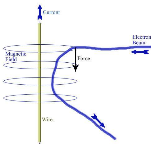

  • #48
Chris Frisella said:
I think I know what would happen if the beams were parallel. Now I am just wondering why an incoming beam perpendicular to the wire would receive a force which is parallel to the wire. I made a little graphic to illustrate what I think would happen. My question is why does that force exist?
See this page, particularly the chapter "A Charge Moving Perpendicular to a Wire"
http://physics.weber.edu/schroeder/mrr/MRRtalk.html
