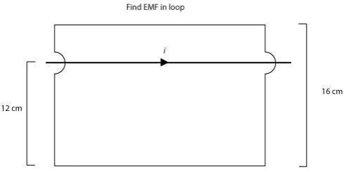

Refer to Figure attached.
The current in the long straight wire is
i = (4.5A/s2)t2-(10A/s)t
Find the EMF in the square loop at t=3.0s.
\xi = -\frac{d \Phi}{dt}
And Biot-Savart law for straight wires of infinite length:
B = \frac{\mu_0 i}{2 \pi R}
Solution: 600 nV
I cannot recreate this result.
I consider two loops, one below the wire in the picture and one above.
I calculate their EMFS separately as:
\xi = -\frac{A \mu_0}{2 \pi R} \frac{di}{dt}
and find the difference between them.
This doesn't reveal 600 nV.
I try integrating with respect to R, and get mathematical gibberish (ln[0]).
I must be missing something fundamental in my setup - any suggestions?

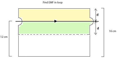

Think about the flux through the shaded areas in the figure.
[EDIT: This can help avoid dealing with r = 0. But I don't get 600 nV either. You will need to integrate.]
[Edit 2: OK, it does come out 600 nV.]
The change in flux for those areas cancel.
So, I consider the third region.
4cm away from the source.
8cm long, 16cm wide (not shown in figure)
\xi = \frac{\mu_0 * 8cm * 16 cm * 17A/s}{2 \pi} \int^{12cm}_{4cm} \frac{1}{R} = 47 nV.
If I don't integrate, and instead just find the difference, I get closer, but it doesn't make sense to do that. ( = 725 nV)
AH!
You were right, it does come out to 600 nV.
Infinitesimal lengths :).
Thanks
