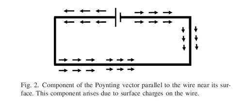

Energy transfer in electrical circuits: A qualitative account
Igal Galili and Elisabetta Goihbarg
Am. J. Phys. 73, 141 (2005); doi: 10.1119/1.1819932
Understanding Electricity and Circuits: What the Text Books Don’t Tell You
Ian M. Sefton
Science Teachers’ Workshop 2002
Energy flow from a battery to other circuit elements: Role of surface charges
Manoj K. Harbola
American Journal of Physics 78, 1203 (2010); doi: 10.1119/1.3456567

FYI, here is a J.D. Jackson paper on the distribution of charge and the roles that plays in circuits. He analyzes a simple case which turns out not to be so simple.
https://pdfcoffee.com/surface-charges-on-circuit-wires-and-resistors-play-three-roles--pdf-free.html
Here is a bit lower level discussion of the topic;
https://matterandinteractions.org/wp-content/uploads/2016/07/circuit.pdf
Here is Jefimenko's early demonstration of surface charges around a circuit;
http://sharif.edu/~aborji/25733/files/Demonstration of the Electric Fields of Current-Carrying Conductors.pdf

Thanks for the article it is pretty interesting. Perhaps you misunderstand my point here. I am not saying the charge and currents can be ignored. The electrodynamic system consists of charges, currents, and fields. (If you want thermodynamics in materials you can couple to other degrees of freedom too!). One should not treat the current like water in a pipe. Wherever there are charges and currents there will be E and H and so they need to be included.
The Poynting Vector is often the simplest picture of the energetics and it is certainly not independent of the system spatial parameters and all the other degrees of freedom.

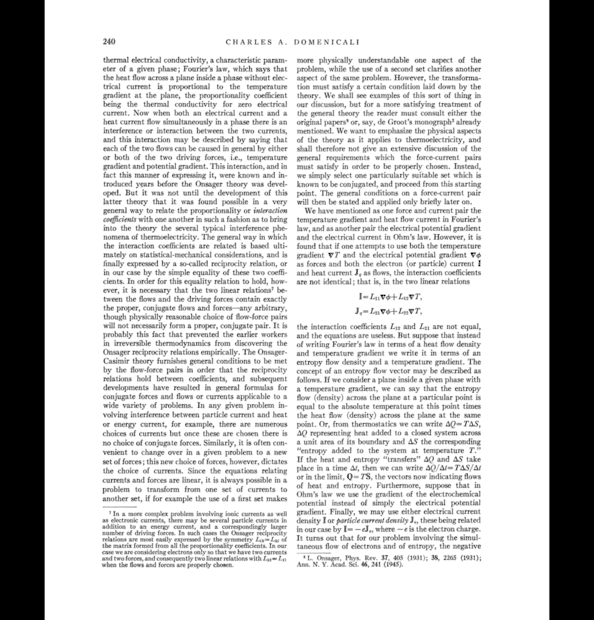

I would also think that no energy (thermal or otherwise) is actually flowing along the wire.
I can offer the following thought experiment:
Let's say you have a very large charged capacitor, essentially a negatively charged slab of metal somewhere and parallel to that some distance away a positively charged slab.
The whole setup can be in vacuum.
Now you connect the two slabs with a wire.
The wire gets hot and gives of thermal energy in form of radiation so clearly there is some flow of energy.
If one wants to think that energy is flowing along the wire the first question would be: In which direction? I don't think there is a sensible answer to this question.
Assuming one believes that energy flows from the negative to the positive charge, that would mean that the amount of energy in the negative slab decreases during this process.
The problem with this picture is that there wasn't any excess energy localized in the negative slab to start with. The available energy was in the form of potential energy involving the potential difference between these slabs, so in a sense the available potential energy was in both slabs.
So it's really hard to maintain that the energy should flow in a particular direction along the wire when you connect the two slabs.
Does my thinking make sense?

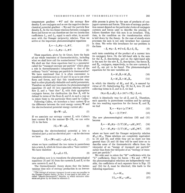

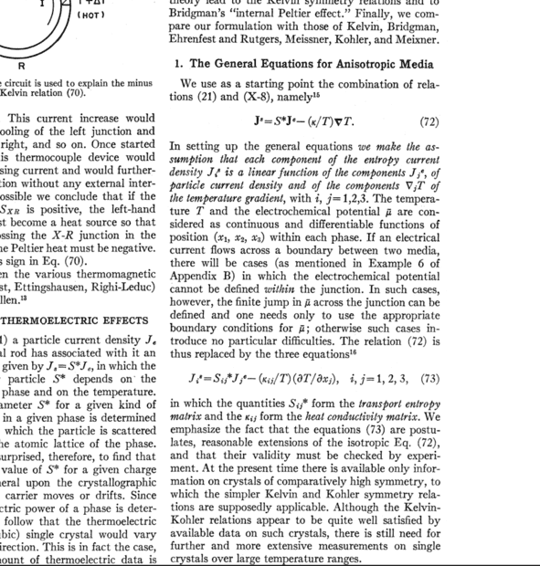

My main point can be summed up as ##\vec{J_U}=J_r \hat r + \textcolor{red}{J_z \hat z}##, where the red part is what the youtubers claim is 0, but I show it isn't zero regardless of whether the resistivity vanishes or not.
I used cylindrical coordinates, z being along the wire, r being radial to the wire.

Sorry for.the confusing notation, it's supposed to be energy flux. So their claim would be 0 energy flux along the direction of the wire, or along the direction of the current.

I am talking about the energy flux inside the wire, specifically. If the wire is ideal, Poynting vector vanishes there, yet there is still an energy flux going along the wire in the current's direction. That's the term in red I mentioned above. The term the youtubers mention its non existence.
