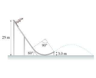

It's been a great day of new, frictionless snow. Julie starts at the top of the 60∘ slope shown in the figure (Figure 1) . At the bottom, a circular arc carries her through a 90∘ turn, and she then launches off a 3.0-m-high ramp.
How far horizontally is her touchdown point from the end of the ramp?
Express your answer to two significant figures and include the appropriate units.
(1/2)mv2i + mgyi = (1/2)mv2f + mgyf[/B]
Solving for V at the end of the ramp I got V = sqrt(2g(y1 - y2))
So the velocity as she is going off the ramp should be Vf = sqrt(2g(25-3)) = 20.8 m/s
Because of the 90 degree arc length the angle she is going off the ramp should also be 60 degrees.
So y = y0 + v0t - (1/2)gt2
0 = 3 + 20.8 sin (60) - 4.9t2
0 = 3 + 18.01t - 4.9t2
t = 3.83
plugging into the x equation for distance
x = vt = v0cos(θ)t = 20.8 * cos(60) * 3.83 = 40 m
I'm not sure why this isn't right. Any help is greatly appreciated!

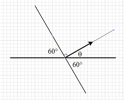

I think you might want to re-evaluate that. If her direction started out at -60° with respect to the horizontal, adding 90° to that yields...?

Does that look to you like 60 degrees in the diagram?
OK I get 30 degrees. Following the same process with 30 degrees I get the right answer. Thanks!
Happy to help!
