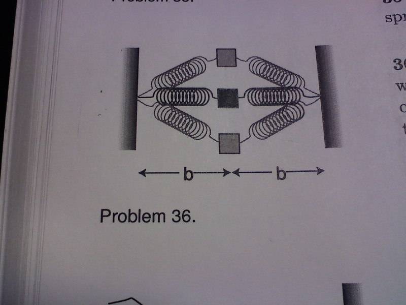

The equilibrium length of each spring in the figure(attached, hopefully it shows up) is b, so when the mass m is at the center, neither spring exerts any force on it. When the mass is displaced to the side, the springs stretch; their spring constant is k.
(a) Find the energy, U, stored in the springs, as a function of y, the distance of the mass up or down from the center.
(b) Show that the period of small up-down oscillations is infinite.
Potential Energy= mgy
or for springs=.5(ky^2)
I really don't know how to go about it, but I've tried using a different equation that our professor showed us that goes (1/2)kx^2 + bx^4. I'm not understanding where the initial and finals are located. Also, the problem says it is stretched to the side so that would indicate a horizontal plane in which the gravitational energy is constant and can be left out, right? It is a symbolic problem so this is all that is given and the answer should be in Joules I believe or Nm-1. I have attached the figure for the problem. Any sort of help would be greatly appreciated. Thanks in advanced! :shy:

The spring oscillating up and down forms a right triangle. The displacement from equilibrium, is y and is the vertical leg of the right triangle the equilibrium length of the spring is b and is the horizontal leg of the right triangle. Then the length of the spring when it is stretched up or down is the hypotenuse, given by,
(y^2 + b^2)^(1/2)
remember that the half power just means square root.
So if we consider how far the spring is stretched it is always given by, its stretched length minus its equilibrium length.
so
change in length = (y^2 + b2)^(1/2) - b
This then gives us a formula for the energy in 1 spring as,
U = (1/2)*k*[(y^2 + b^2)^(1/2) - b]
then the total energy in the two springs is,
U = k*[(y^2 + b^2)^(1/2) - b]
Thats the answer to part one.
Second we must show for small oscilations that the period is infinite.
now let's sum the forces on the mass at the peak of its motion.
let A be the angle between the hypotenuse and the leg b. then the displacement, y, is given by,
y = b tan(A)
and,
Cos[A] = b / hypotenuse
hypotenuse = b / cos[A]
so we can write the spring force equation as
k*(change in spring length) = m*a(y-direction)
since the spring pulls back along the direction of the hypotenuse we must divide its force into components to find the total force in the y-dirction, and get the differential equation for the y motion. Since the x direction forces are equal and opposite, they will cancel. so for the vertical force we have,
-2k*(b/cos[A] - b)sin[A] = m *y''
Note the two comes from the fact that we have 2 springs, and hence two vertical components.
here we can write y = b*tan[A]
and for very small A, 1>>>>A
tan[A] = A
so y'' = b A''
and the differential equation becomes,
-2k*(b/cos[A] - b)sin[A] = m *b*A''
here the term -2k*(b/cos[A] - b) is like the spring constant for the group of springs, so the frequency of oscillations is,
w = [-2k*(b/cos[A] - b)/m]^(1/2)
but we also note that
1>>>A
so
sin[A] = A
and
Cos[A] = 1
so the equation reduces to,
-2k*(b-b)A = m*b*A''
If youll notice the constant in front of A is zero. so
w = [-2k*(b - b)/m]^(1/2)=[0/m]^(1/2)=0
so
w = 2*PI*frequency = 2* PI/Period
0 = 2* Pi/period
1 / period = 0
so the period must be infinite.
So this ends the problem.
