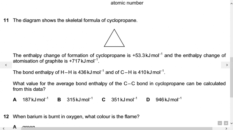

6C-H bonds= 410 x 6 = 2460 kJ/mol
3C-C bonds
H of formation= +53.3 kJ/mol
H of atomisation = +717 kJ/mol
H-H = 436 kJ/mol
as H of formation is 53.3, can't I just do:
2460+3x=53.3?
But then I am not using a lot of the values provided and the answer in not in the options.[/B]

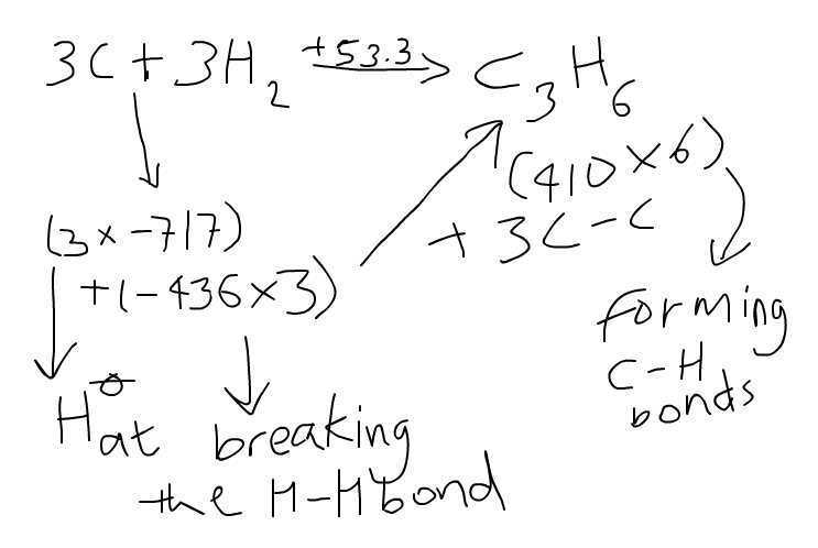

Actually, I don't know what to do at all. I know that I have make a Hess's cycle so that I can form equations. But I can't figure out the Hess's cycle here.
What is Hess's cycle?
The total enthalpy change is the same for all the routes the reaction can take to produce the product.
Correct. What route are you taking?
Let the C-C bond energy be x
(3*-717) + (-436*3) + (410*6) + 3x = 53.3
-2151-1308+2460+3x=53.3
-999+3x=53.3
3x=1052.3
x=350.767
approx. 351 kJ/mol
But the answer should be 315kJ/mol.
